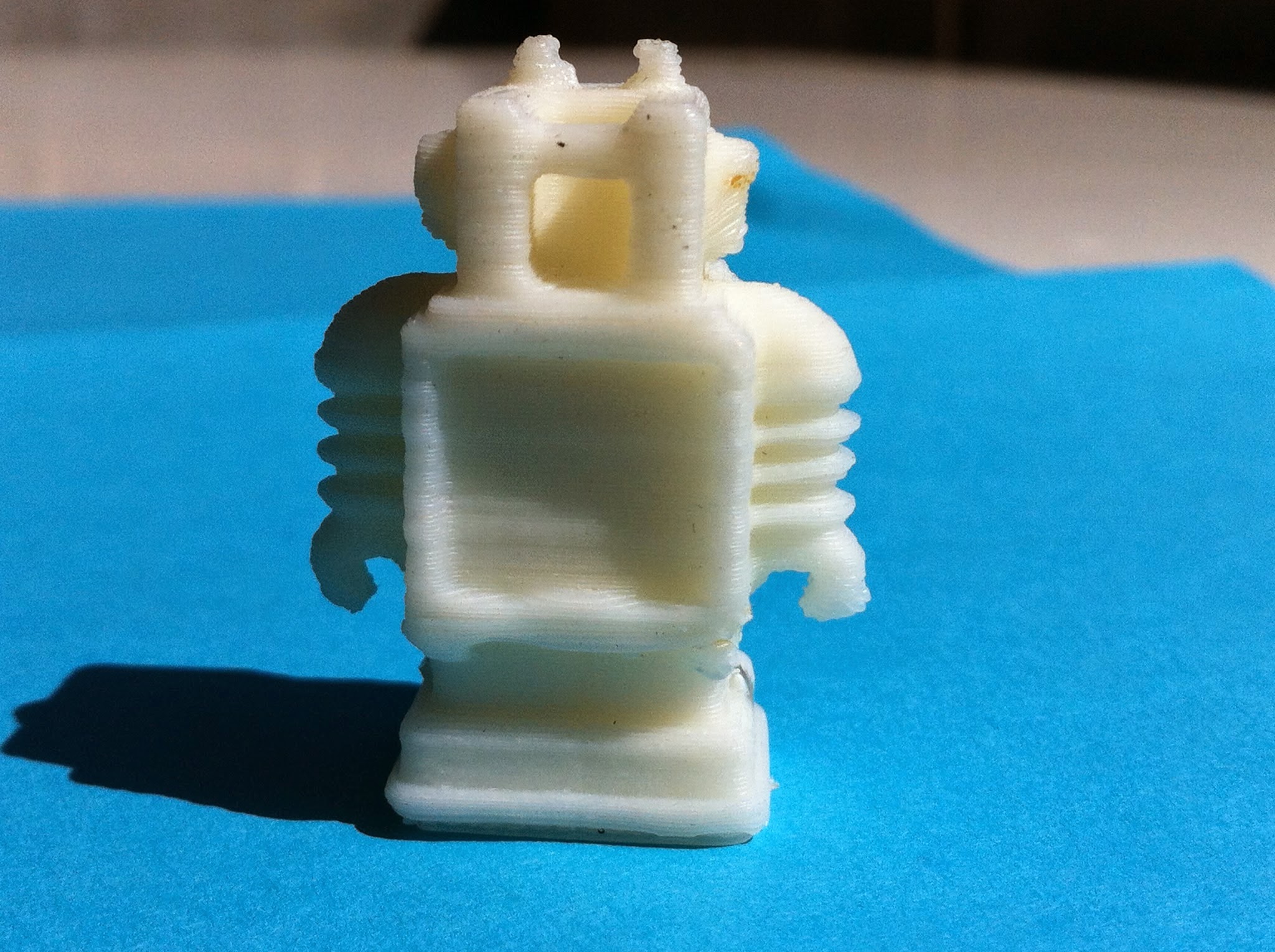

some more prints after I adjusted the carriages (tightened the screws to remove play) and fixed the extruder problem.
Any comments about the Quality? I don’t know what to expext, all objects are printed in ABS @about 270 to 280°, the cube and the robo have 50% infill the gardena water rocket cap 100% to make it water proof.
I use a e3dv6 3mm bowden hotend with 0.4mm nozzle
Print speed is still quite low @40mm/s, acceleration is set to 3000mm/s^2. what can I expect? 100mm/s? 200mm/s
The hotend groove mount might be a problem if I increase the speed and acceleration too high, maybe I can secure the hotend with a cable tie. I already added an extra guide for the bowden tube to the cariage above the hotend because when the hotennd moved, the angle of the bowden tube changed and this also moved the hotend a little bit. now this should not hapen anymore. What is the limmitation of the hotend in terms of extrusion speed?
