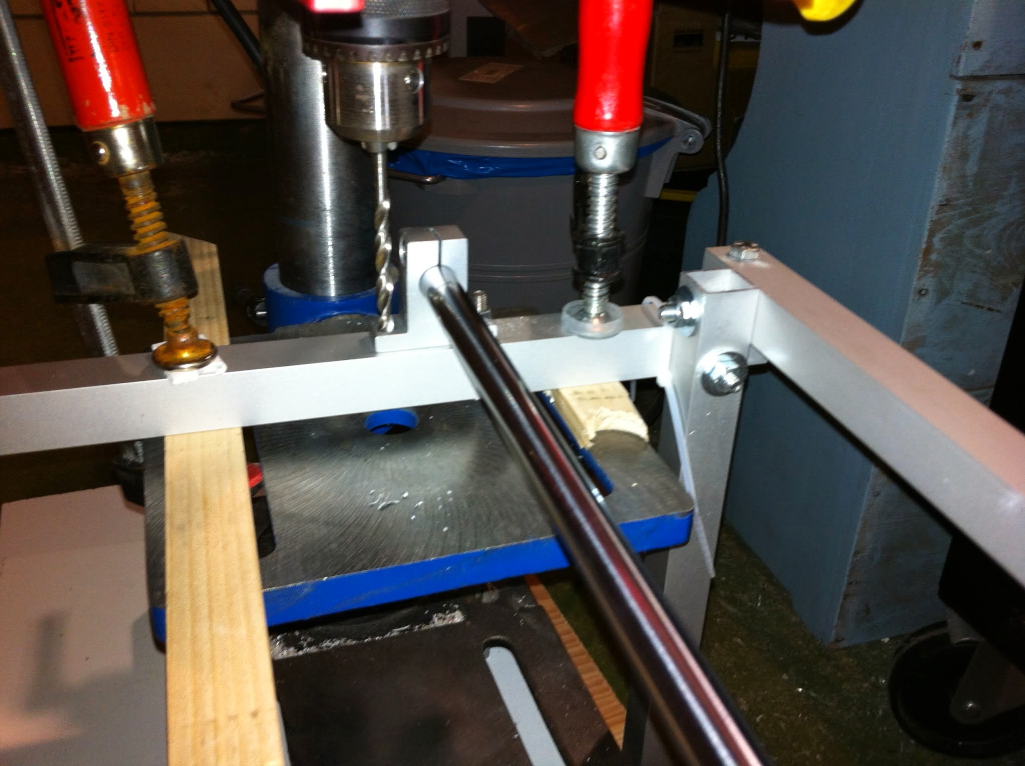

Added some pictures of the Z-Axis. 10mm ACME srew with 2mm pitch. The nut is red brass, the shafts are 12mm. Lead screw, nut and shaft are from http://www.dold-mechatronik.de/, bearings and couplers are from eBay.
