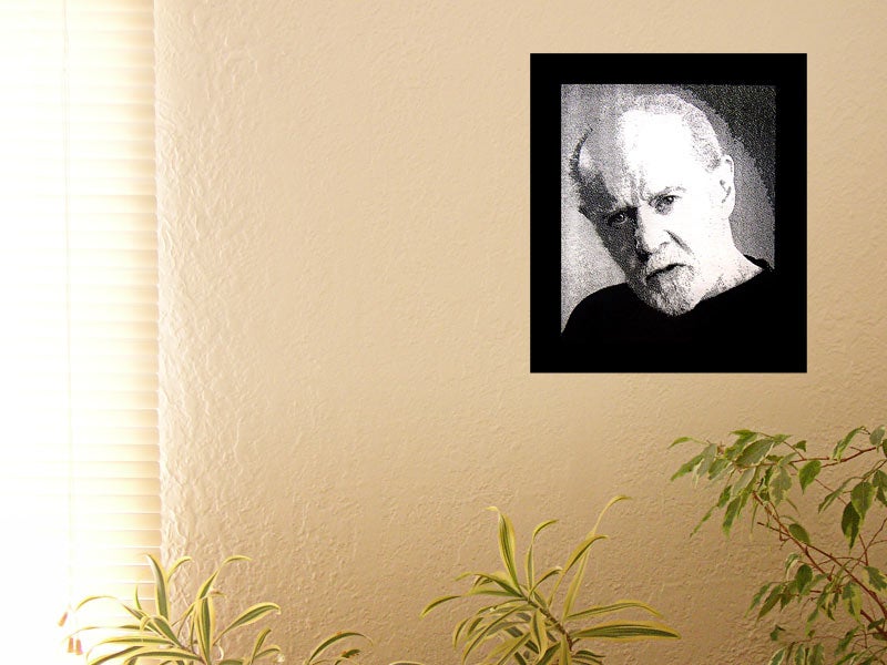

Change it to a grayscale/black and white. Adjust the contrast as needed. For an interesting effect, (I use photoshop) change it to a bitmap with about 60% dithering. Then reverse it and mirror it… spray one side of a acrylic sheet with black paint. Engrave it through the black paint. Clean it up a bit to remove dust from engraving and then paint over the black and engraving with white paint. It makes a very nice high contrast black and white “photo” suitable for mounting!

Here’s a link to an “instructable” on the process I mentioned.
@Coherent Thanks for that Marc. I can probably use a similar method for what I want to do on leather (minus the paint).
@Coherent Thanks again for that Marc. Just ran some tests using that method now & it’s looking great. Not quite finished though.
