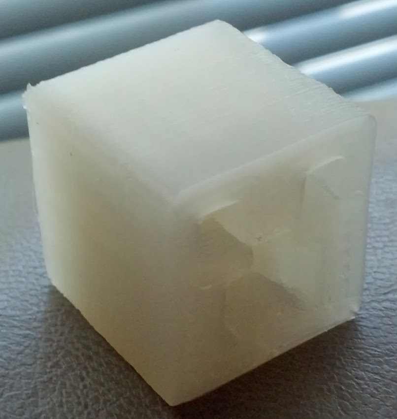

I printed this to experiment with re-homing the X and Y axis after each layer. The concern was that variation in the homing switches would introduce more error than it was worth to prevent an accidental loss of position due to e.g. a sticking filament pulling the print head, or someone bumping the table during printing. As far as I can tell, the re-homing introduced no error on my Printrbot Jr, and since the part was positioned close to home, and is a pretty small part, it cost very little extra time.
For narrow, tall prints, I recommend adding:
G28 X0 Y0 ;rehome X and Y only.
to the layer gcode. It will keep the print from being destroyed when “Murphy” comes knocking.
https://lh6.googleusercontent.com/bF3g-7GK0NOIBLvXzvoCixCsIyJZXpiPDvbSbDObAlI=w806-h851-no
Well, I have found one problem with re-homing X and Y every layer: The extruder tends to drool a bit and then when it returns to start printing the next layer, that blob gets “wiped” off onto the side of the part being printed. You get these little “rain drops” down the side of your part. They seem to crack off pretty easily, but I’ve not been able to get rid of them, even with increased retraction. Maybe I just need to retract more…
