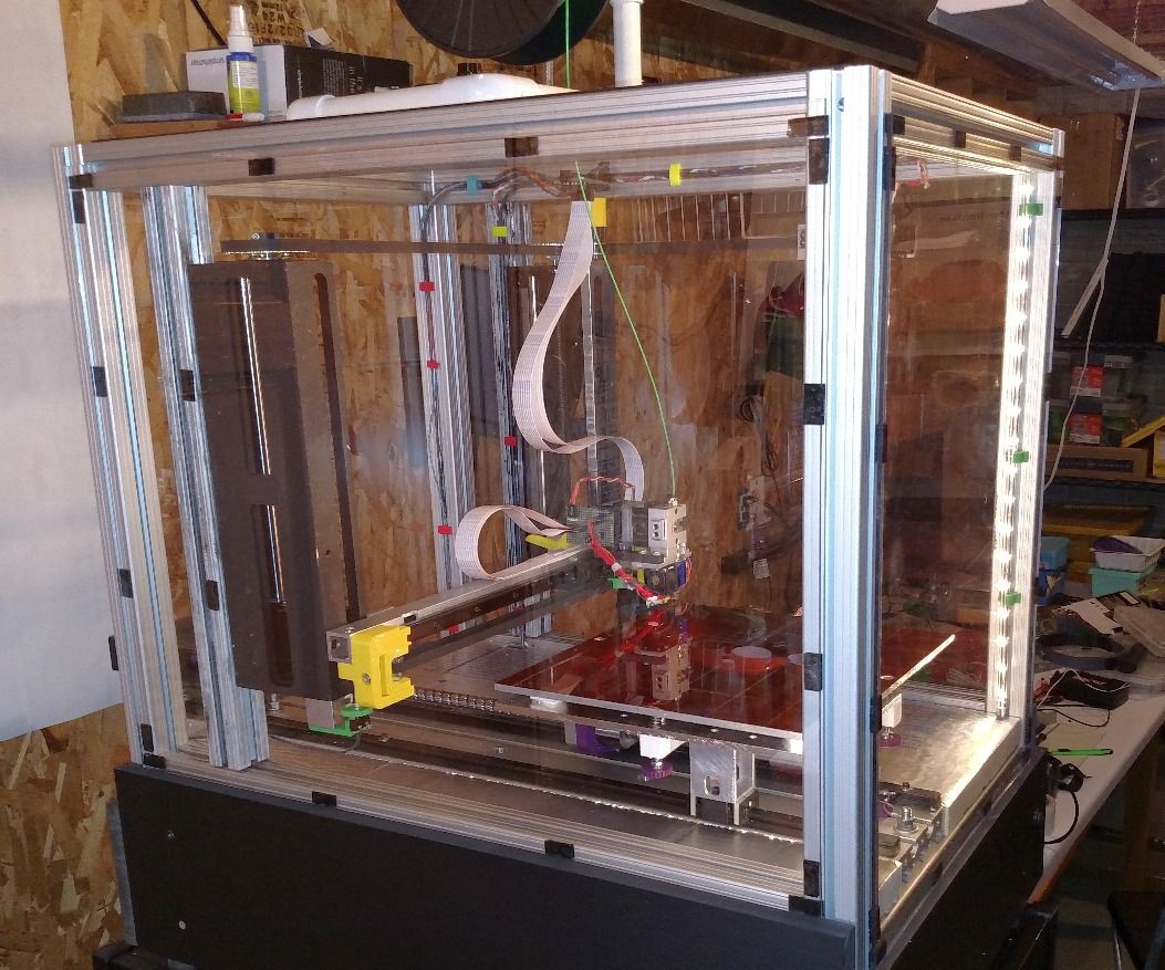

Moving the platform on large machines is not very space-efficient, and it makes machine rigidity more difficult to control. Have a look at the Herculien and Eustathios machines: https://plus.google.com/communities/108524206628971601859?utm_source=chrome_ntp_icon&utm_medium=chrome_app&utm_campaign=chrome

For rods seeing variable side-load (such as Ultimaker gantry cross or i3 Z stage) diameter should be around 1/35-1/40 of the span for Bowden or 1/25-1/30 for direct drive. Rough ballpark for initial design. Diameter needs to be nearly proportional to length! That puts you into downright stupid rod sizes for big spans. DO NOT USE ROUND RODS OVER 400mm SPAN. Switch to v-wheels on extrusion or linear rails bolted to extrusion.
@Ryan_Carlyle Thanks, I sort of thought Id have to move to a different rail type. What I really wondered on was the relative mass of the bed v the head, ie it becomes better at some point to more the head as its lighter?
@Steven_Mething yes, my personal opinion is that i3 style Y beds stop making sense over about 200mm usable X or Y dimension. Aside from the moving mass, the flex wiring for heatbed power starts to get more and more unsafe at higher bed powers. Reasonable people can differ though. It just makes less and less sense as you scale up.
