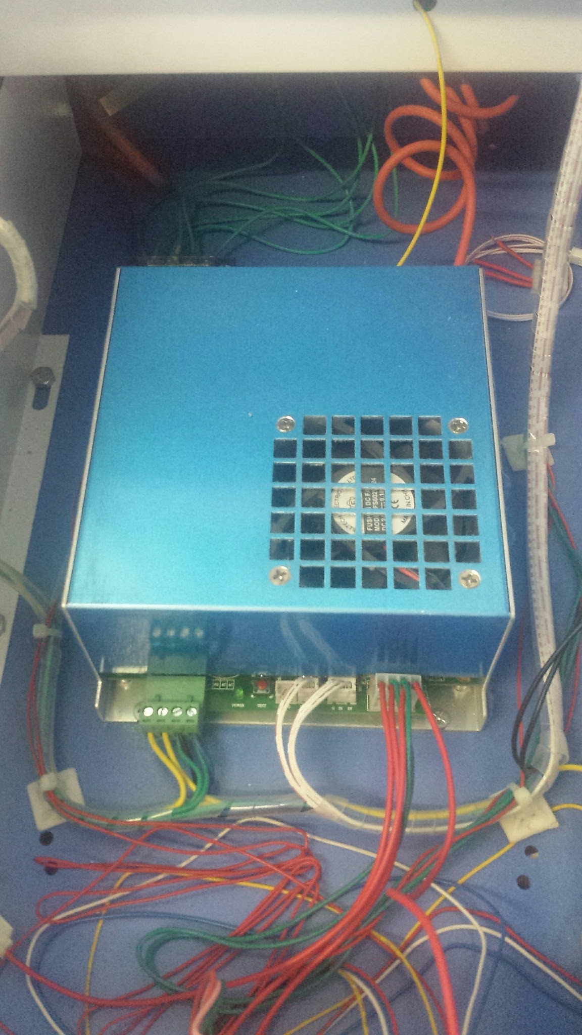

Picture of supply please?
@donkjr ​ sorry for the delay. Here is a pic of the PSU.
@Andreas_Benestad Have you tried:
With the laser switch on
  1. Grounding the L pin on the right connector
  2. Pushed the test button down on the supply?
    Without the laser switch on
  3. Is the green led on the LPS on?
  4. Measure 24V and 5V on the rightmost connector?
