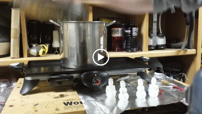

Quick acetone vapor smoothing video of my snowman army.
Seems like the kind of thing I would do outside. :slight_smile:
Awesome!
@David_Galloway this is my garage. But one nice thing is acetone vapor is more dense than air. So actually other than the limited amount that wafts out when you disrupt the air currents lifting things in and out of the vapor bath… There is no smell.
Thanks for the inspiration. Finally gave it a go myself.
@Richard_Mitchell do you have a picture of the results?
Just posted it up now. I reckon I didn’t let the cloud of acetone form up enough.
