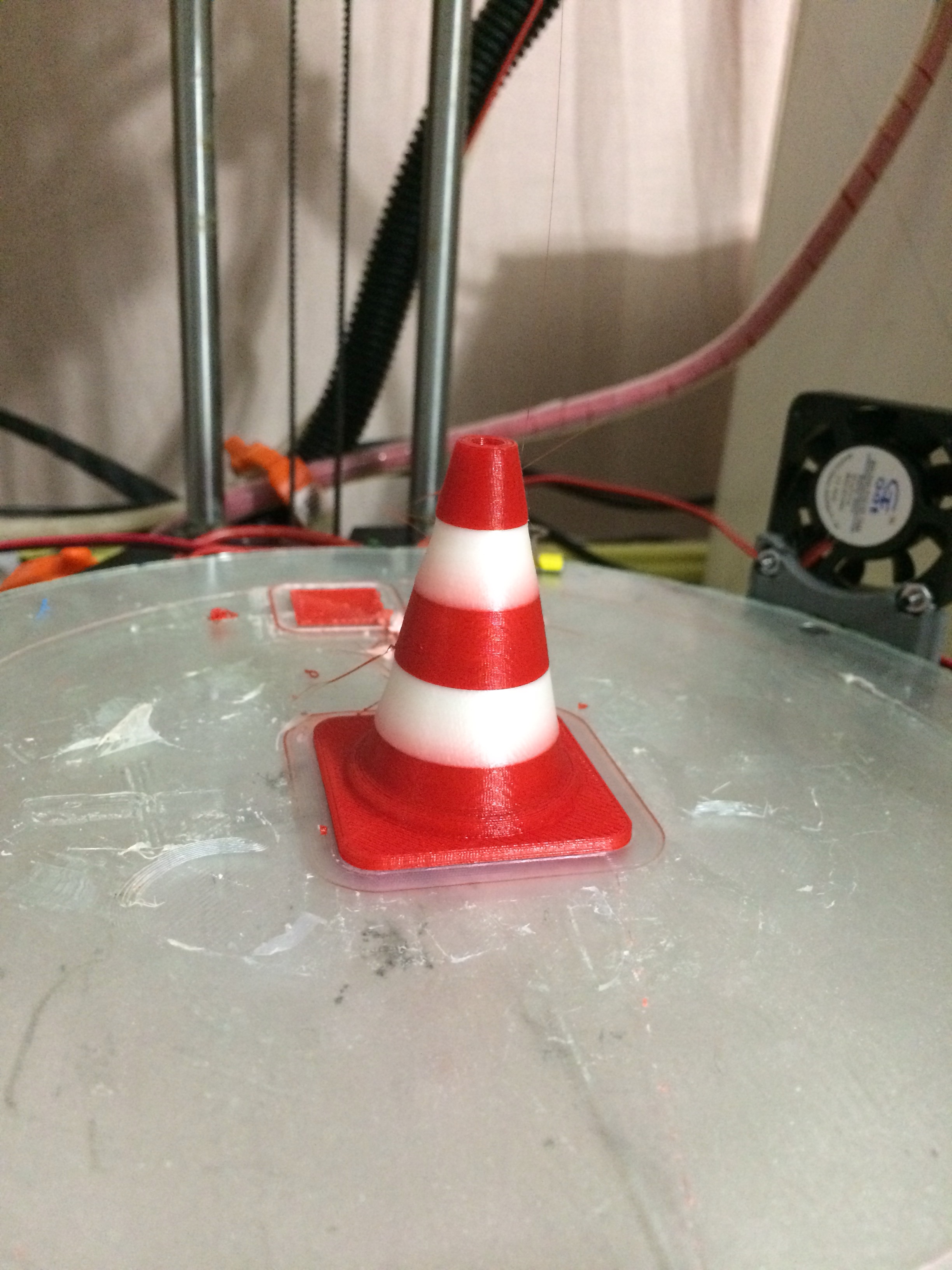

Quick demonstration of using PETG (red) as a surface-to-surface support material for PLA (white)
Quick demonstration of using PETG (red) as a surface-to-surface support material for PLA (white) using a single extruder (230c constant temp).
Purge tower removed, but 60mm^3 purged for each tool change.
PETG bonds lightly with PLA, and at 230C, only slightly more to itself.
Interfaces required a slight pull with pliers, but detached cleanly at the PETG/PLA boundaries.
The slight red at the bottom of the white rings is excess red PETG pigment that was flushed out after the toolchange.

@Adam_Steinmark about a year ago I was playing around with 2 hotend dual extrusion, and had tried to make a PLA part with PETG hinges (for wear properties), and it came apart at the PETG/PLA boundaries.
Ergo - PETG as a contact support material.
