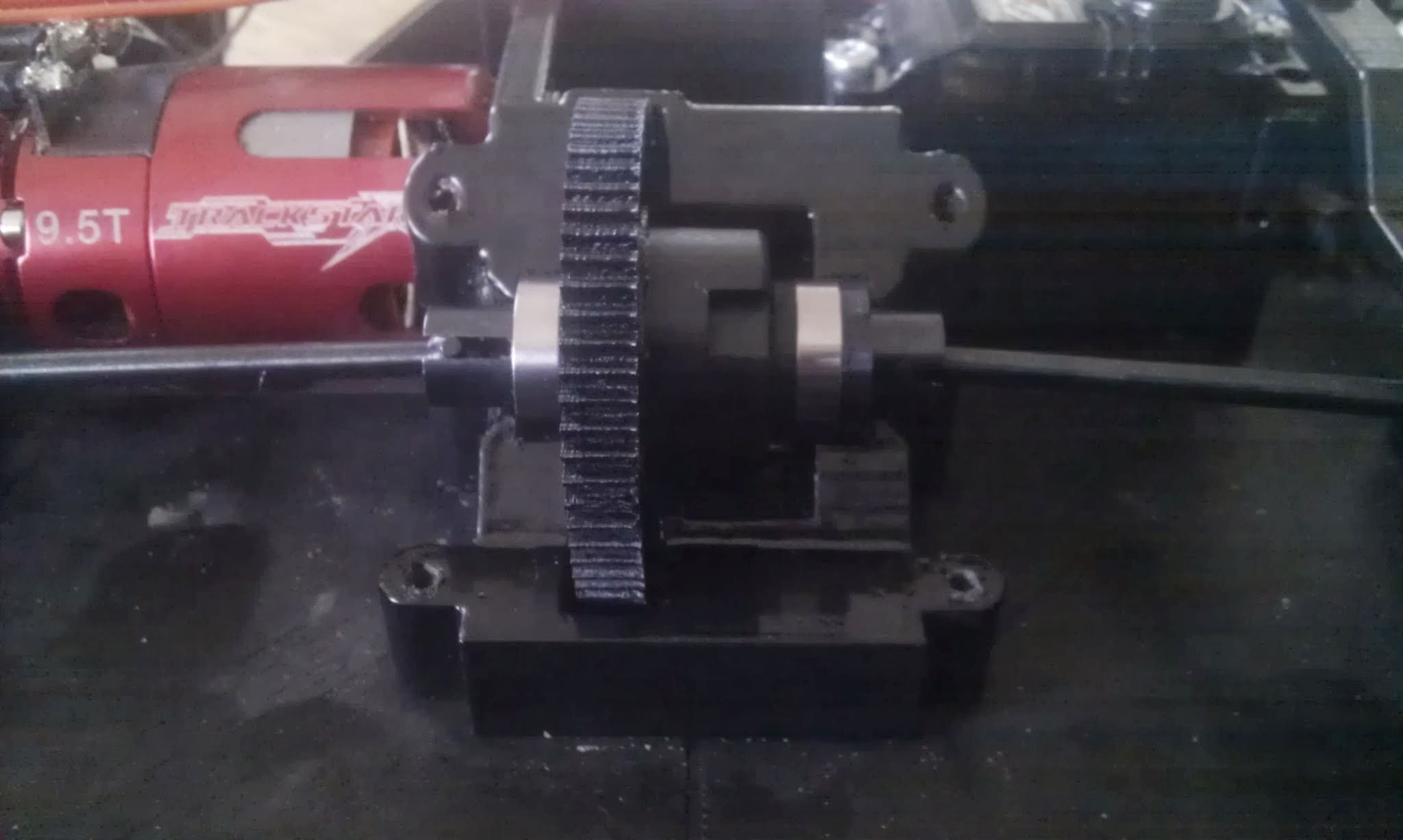

Quick, dirty and cheap hack to a metal gear center diff.
Quick, dirty and cheap hack to a metal gear center diff. Spacers are needed because the metal gear diff is slightly smaller. Let’s see how it holds up. Sometime in the future i’ll modify the center diff housing.

Of course, that’s in the spirit of this project, isn’t it. The diff used is a cheap chinese (ebay) part HSP 02024. You’ll need longer drive shafts for it i’ve used HSP 08029 but it would be better if they where another 2mm longer. https://dl.dropboxusercontent.com/u/96359783/Diff%20Stl/Spur%20Gear%20Drilled%20-%20m%3D0%2C7%20Z%3D65_HSP_EWK.STL https://dl.dropboxusercontent.com/u/96359783/Diff%20Stl/Spacers.STL
I did the same for the front and rear diffs. Due to the changed total length of the diff,slightly scaled suspension and steering parts are needed. (diffs are only about 5 euro’s) Haven’t tested it yet. https://dl.dropboxusercontent.com/u/96359783/DSC_8833.JPG
