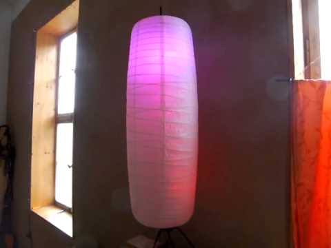

Quick matrix proof of concept
Because I’m lazy I just coiled 4m strip arround a transparent tube inside the diffusor/screen. I’m pretty happy with my “360 angular degree spiral backpro matrix”… ![]()
In case someone wonders about the sketch - here it is:
