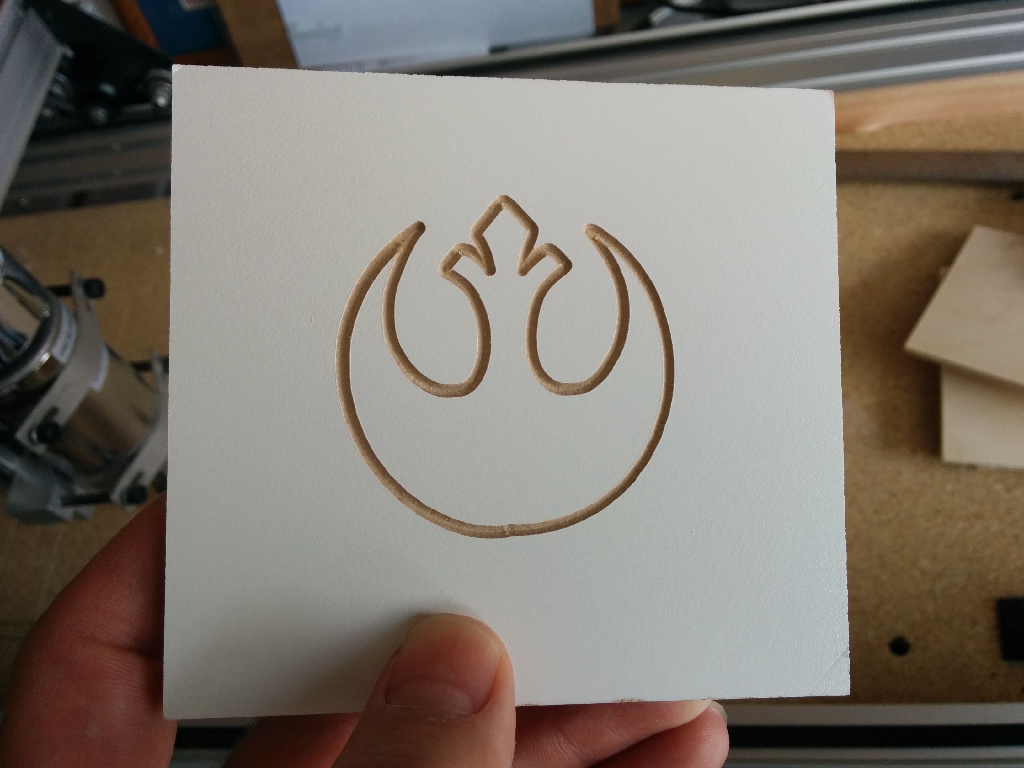

Quick project my son wanted made...
Quick project my son wanted made… What a #rebel
shapeoko cnc
Nice. Would you mind sharing your workflow?
I can see a little lost steps on the bottom part.
@Brad_Dudenhoffer This was a simple Google search for a logo, then opened up inside of Inkscape. Trace the Bitmap, object to path, save as DXF. Then I used F-engrave for this one.
I cut out another one from 1/8" plywood using http://www.makercam.com to generate the gcode.
@Camilo_A_C You are correct on the lost steps. I’m sure it was my feed rate being too high and my depth being too deep for that speed.
For this project I’m not too concerned about it. Very good catch though!
He was super excited about his new stencils!
