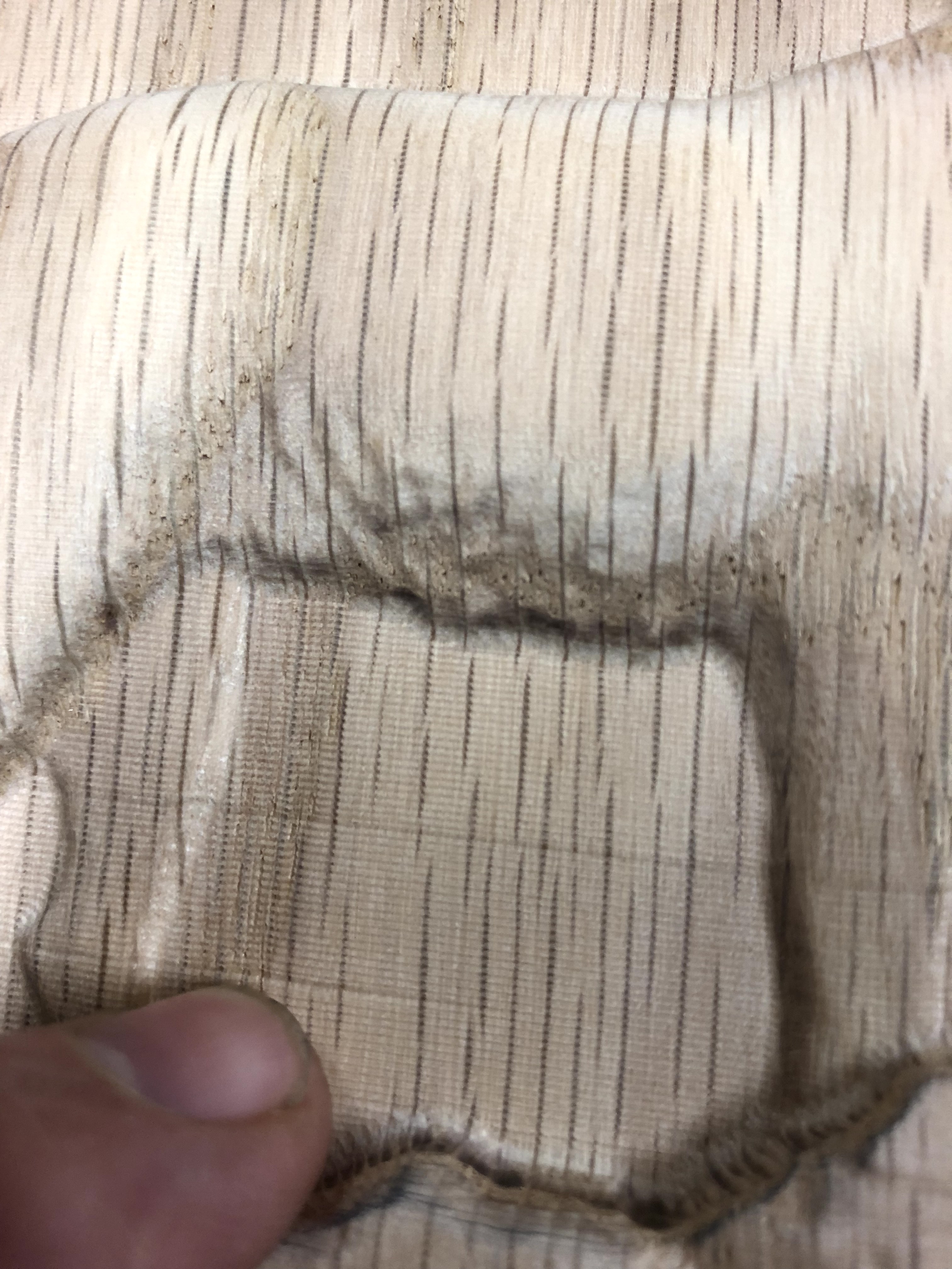

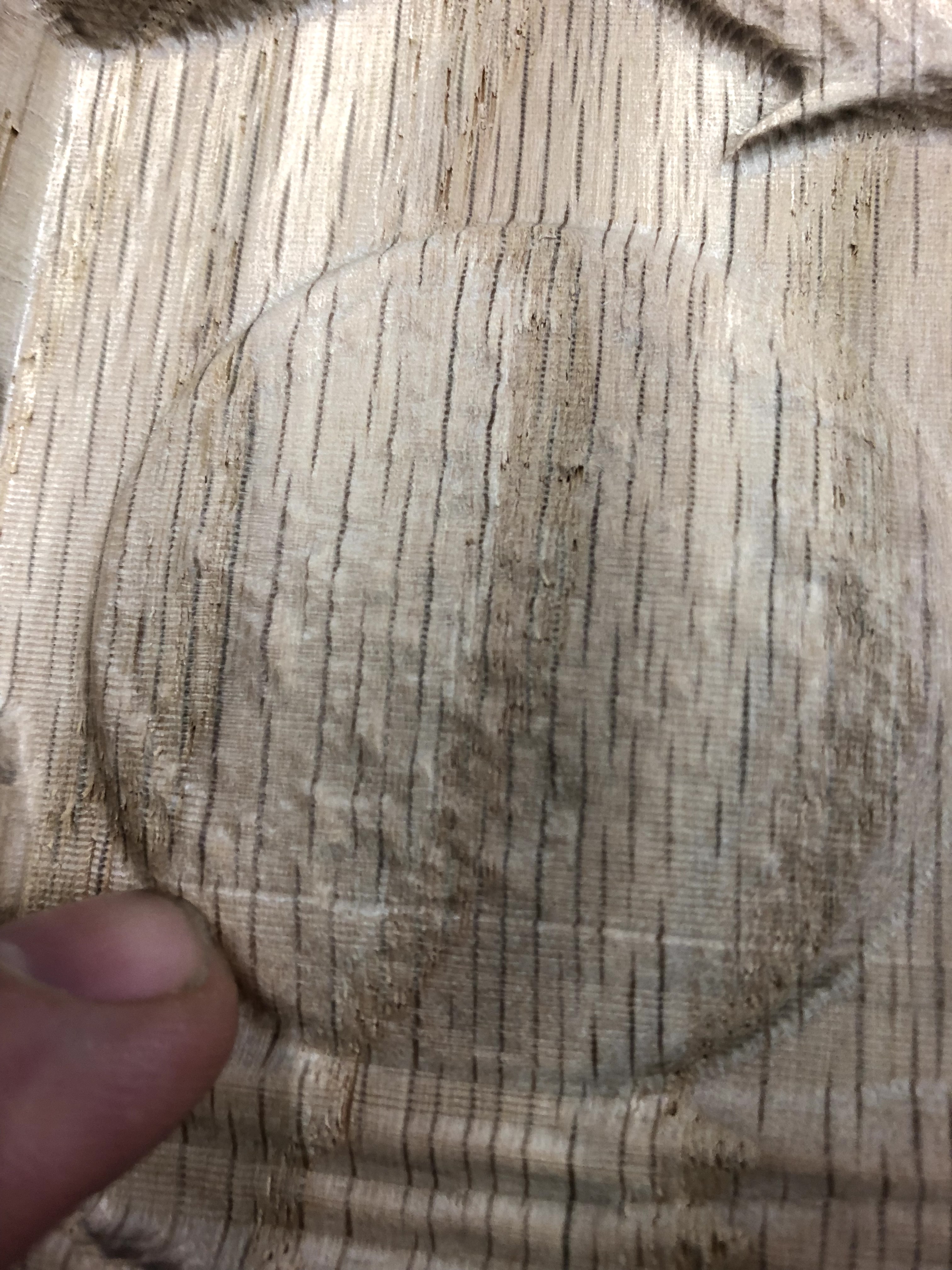

Quick question. I am having an issue on the finish pass of a 3D carve where occasionally it will leave a line that stands out. It is very random. I just did a carve that was 14" and it left 3 lines in it overall. Anyone had any issues like this or suggestions on what might cause it?

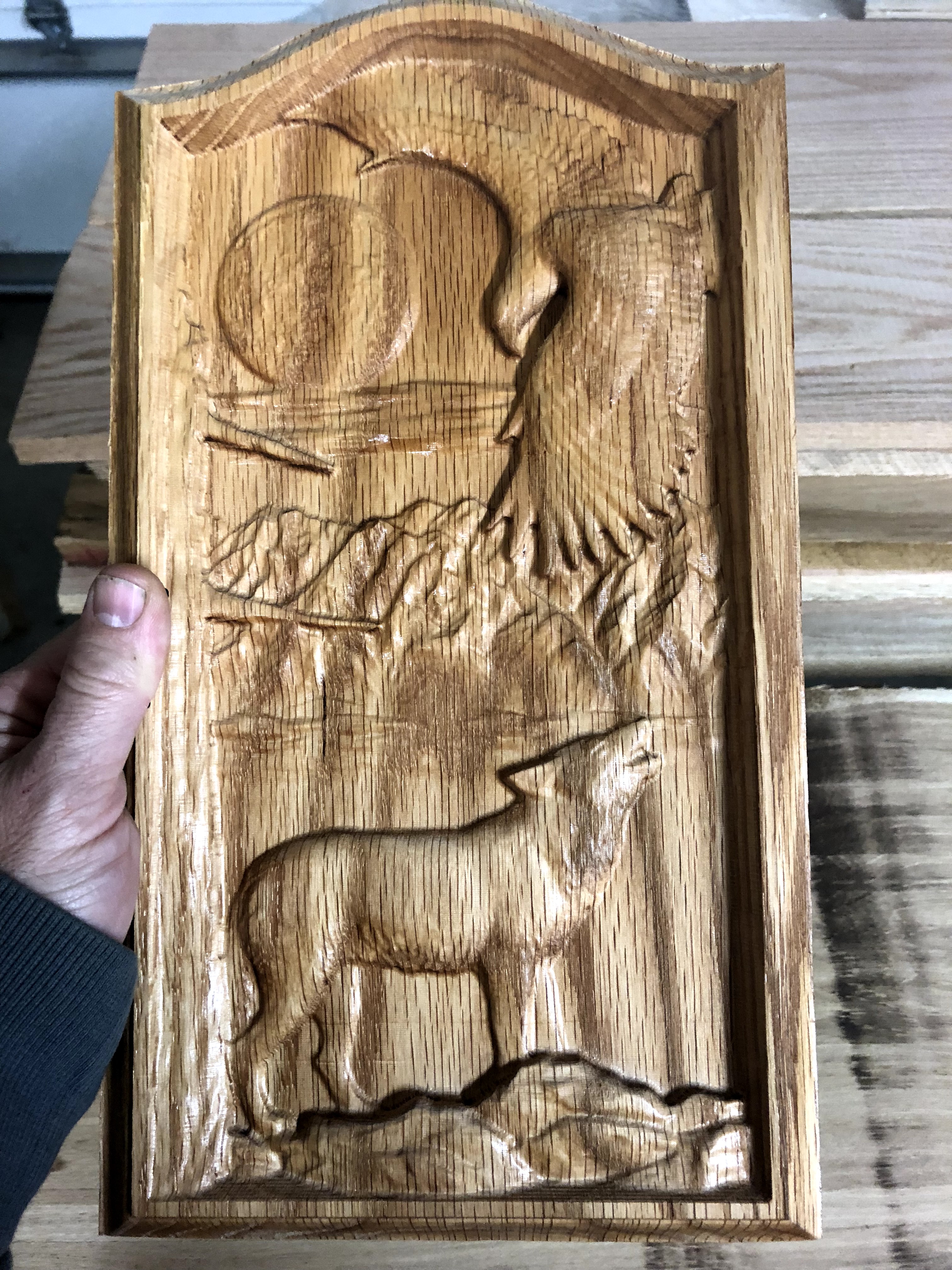

The wood looks awesome!
@Darren_Lee thanks. It is red oak. It really looks good with a coat of poly on it.

Ran the same carve again and it left lines in different spots this time.
So that rules out the G-Code itself. When my Z axis slips it never recovers and every line would be lower after the slip. Could the bit be picking up a contaminate? I have had aluminum burrs that damage the work.
$1=255 locks the motors in GRBL.
What end mill is leaving this line? Ball end?
@Brandon_Satterfield .125 ball
@Brandon_Satterfield it has also left a raised ridge in one spot
