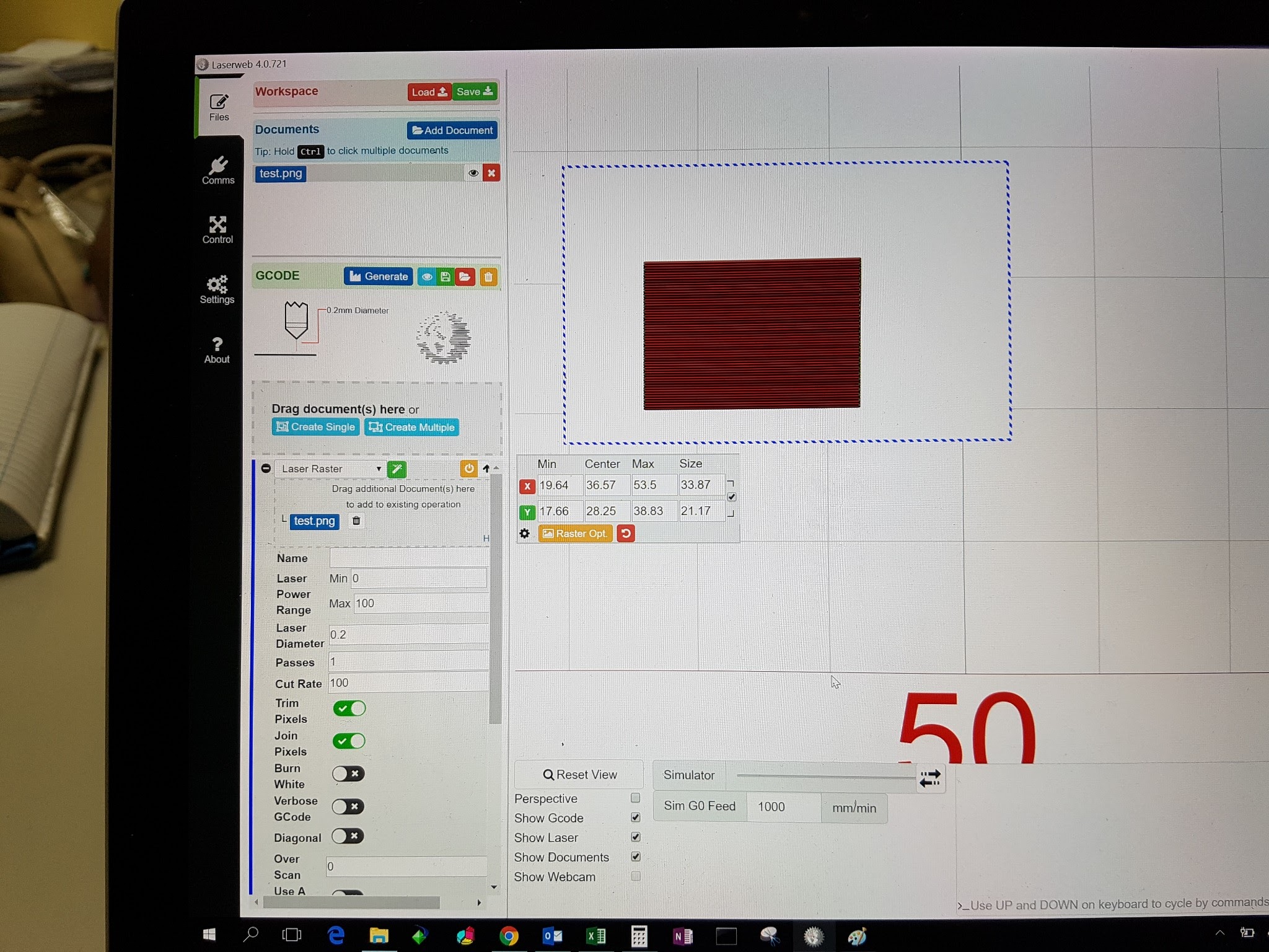

Quick question…in lw4 is there a way to make it so the machine doesn’t do the travel paths on backgrounds? I turned off burn white background but it still does the travel moves. This adds a lot of unnecessary time to projects.

What do you mean by “travel paths”. Have you verified that the area that its erroneously travelling is really white?

I know it did have no background(transparent) as I cut my kids out of another pic. So it should be totally white, I’m going to double check after work. Thanks for the reply.

I figured it out that it’s the type of processing I’m doing. It adds up to lack of knowledge about image processing. Still needs to test a few things but I think it might solved
@Chris_Menchions 's image was dithered and as a result the “white” was not really white. Some pixels were imaged to create “light grey” in the “white” space which is why LW created sweeps across those areas that looked white. The power was turned down enough that the background grey did not show up when marking.

@Chris_Menchions Correct. If You use photoshop, create an image and then “File -> Save for web” Choose PNG-24 and tick checkbox for “Transparency”, then save an image. And if You had a transparent background in photoshop, Your image now will also be saved with transparent background. Now in LW4 turn off “Burn white” and check the simulation or simply run the job and You will see that everything works as it should.
