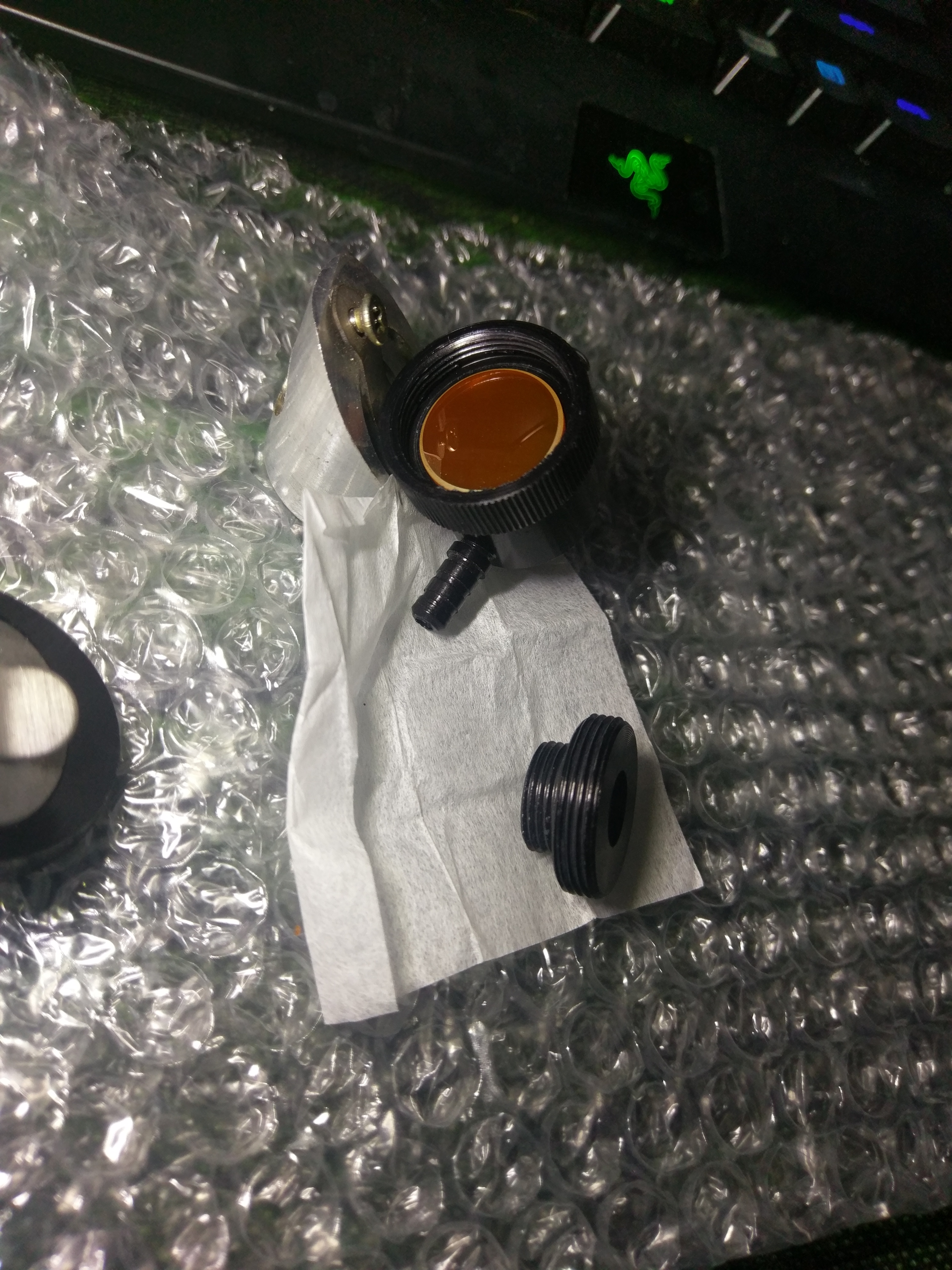

Quick question. Won't screwing this part of the LO head in until it's tight,
Quick question.
Won’t screwing this part of the LO head in until it’s tight, make contact with the lens and absolutely destroy it with scratches and pressure?
Just making sure I’m not doing something wrong.
it won’t screw all the way in to make a flush surface as it hits the lens before that point…
To me it looks like (depending on the material used) it may scratch the lens but the beam will not hit the scratched part anyway?
Hard to tell, you also don’t want the lens to be lose. :-/
What if you put an O-Ring between lens and adapter so it won’t hit the surface of the lens?
I’d think you are right that it would scratch the surface of the lens.
@Christoph_E I think that is what a few people have done if I recall correct.
good point Chris on the scratched part not being the part the laser passes through. But it just seems unprofessional that the design asks for you to screw this metal piece in until it makes contact with the lens in order for the assembly to be tight.
Thanks Yuusuf - if that is what others have had to do then it sounds like the way to go!
I will look for a soft spacer to use.

I just snugged mine up … probably does scratch the edge. “Professional” and K40 parts are not usually words that fit in the same sentence :wink:

I destroyed my lense on my K40 by screwing on the original lens holder too tightly…
I think I may just have realized why I did not damage mine: http://donsthings.blogspot.com/2016/06/k40-air-assist.html
