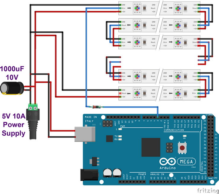

I have a light plate project with a mega arduino, and ws2812 addressable leds.
These are installed as a S (see image 1).
10 lines x 60 leds
Image 1:

Do you think it is feasible to put your Fire2012 code on the white light up part?
If I change my drawing or first name on my 2D board, will everything have to be changed to the Fire2012 code? The idea would be that it follows the lit part.
