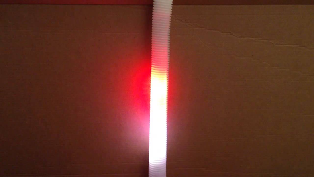

Quick video of “Fire2012”
Here’s what the “Fire2012” fire simulation looks like when running. Here it’s running on a strip of thirty WS2812B pixels on one of those high-density 144-pixel-to-the-meter strips. Microcontroller is an Arduino Nano. The LED strip is diffused through a section of white ‘cable organizer’ tubing (technically “split loom tubing”).
Source code is here Fire2012: an Arduino/LED fire simulation for FastLED - Pastebin.com
Definitely looks best with the FastLED v2.1 Beta release, but works fine with the v2.0 release, too.
Those high density strips make the effect more realistic looking.

I haven’t noticed any difference in (general) output with the FastLED2.1 library - as I understand the dithering function is enabled by default? Is there anything I have to do to get dithered output?
Yep, dithering is enabled by default. It makes a more and more visible difference as you lower the master brightness control with FastLED.setBrightness(…)
I have it running at brightness 40 due to power (battery) restrictions, I will do some more tests tonight.
Excellent. That’s exactly what it’s designed for! At lower brightnesses like that, dithering should help colors look better and the overall animation look smoother.
For best visual results, replace calls to regular “delay(…)” with calls to “FastLED.delay(…)”; the library will use the time to keep the LEDs actively refreshing with dithered output.
