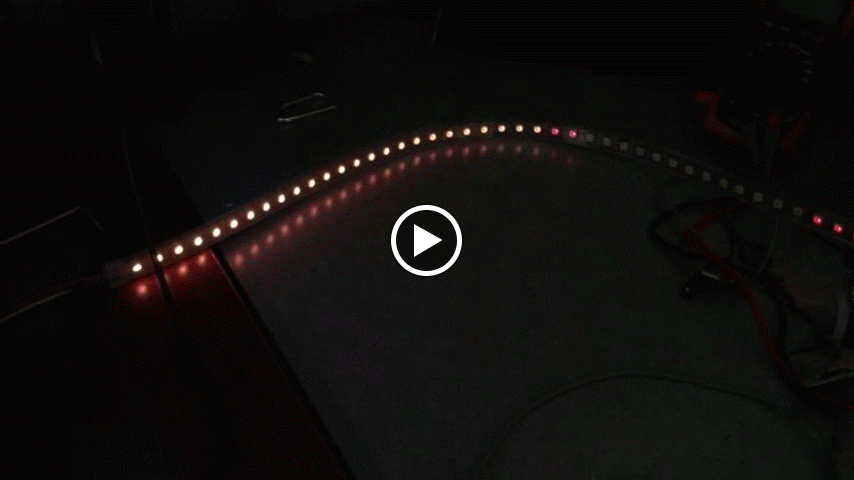

Quick! What brightness level is this code running at?
Quick! What brightness level is this code running at? :slight_smile:
(screw you google, this is a 15s video, why are you still processing?)
For extra entertainment while I’m waiting on answers (and before spilling the beans :slight_smile: - https://www.youtube.com/watch?v=IkMPZ7WeDck&feature=youtu.be&t=2m36s
As much as I like Jason’s answer, I think John’s got it pretty close, as it’s dark and the LED’s aren’t blasting at the camera.
Both of them.
Ding ding ding! we have a winner… Assuming that is, that @Robert_Atkins meant “2” :slight_smile:
(Because of the math involved, a brightness of 1 would have resulted in all the leds being off :slight_smile:
I’ll bet 1, just like on the price is right.
If it was 1, then the leds would all be off. (It’s a side effect of how we do scaling. Fixing it, however, would turn scale8 from a deterministic 4 clock cycles on AVR into 3 or 6 clock cycles - we opted for deterministic & faster for the time being, but may revisit that in the future, especially as people move to arm).
so the fades are a result of temporal dithering? Is it cause the APA 102 allows much faster framerates that you can do this?
Yeah - you can do it with ws2812’s as well, but you are capped at 400Hz as an update rate and you can really only get that if your strips are short (eg under 60 LEDs)
I was actually trying to be clever, thinking it might be a combination of FastLED’s dithering and the APA102’s built-in brightness management. But I’ll take it :slight_smile:
@Robert_Atkins It’s better to be lucky, than good.
