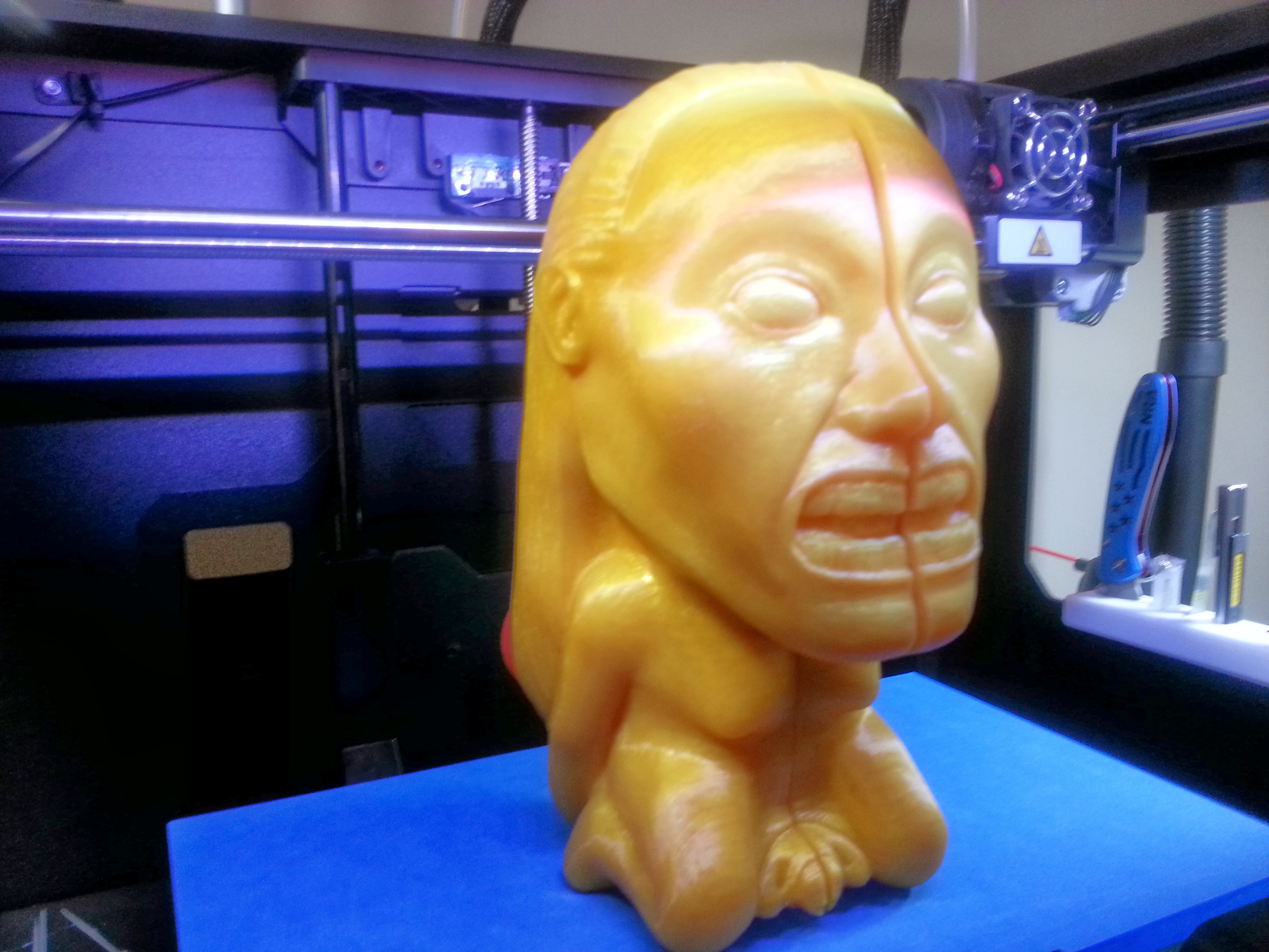

Raiders of the Lost Ark Fertility Idol Each half took a little over 16
Each half took a little over 16 hours to print
I should have printed with a raft… the pieces curled up a little.
I will reprint with a raft and see if they fit together better
MakerBot Replicator 2
Prototype Supply Gold PLA
20% infill- 2 shells- .20 mm layer Height
Total Print time- 32 hours 44 min
original - http://www.thingiverse.com/thing:177588
This is the kind of thing the MakerBot would build, laying down, epoxy together, and spend a ton of post-processing time hiding that seam, and place upright on their bed with a do-not-touch sign…
I will try again with a raft to see if that helps
Maybe do the body and head separate and make it a cookie jar! : )
Perhaps I’ve missed it, but I’m curious to the size.
8" tall
