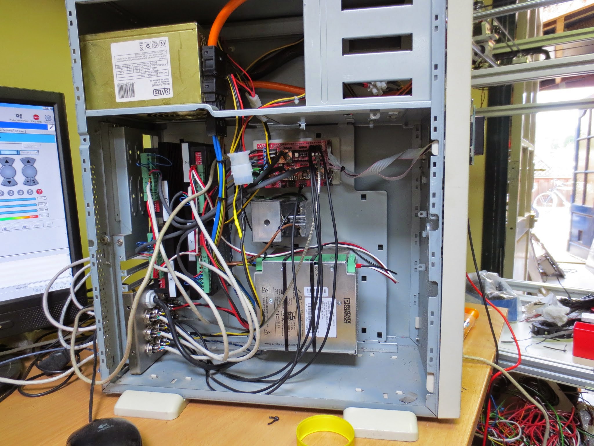

Ramps on steroids. Since I didn’t have very good results with the standard stepper drivers, I switched to a bigger version. Therefore it became necessary to create a bigger enclosure.
This is what it became.

Very nice. Curious Minds want to know:
I see the Ramps up-top. What’s that in the middle, a transformer?
I see the four grey lines running to your humongous steeper drivers but what’s the silver, green & black box at the bottom?
You’re currently running 4 drivers but your box is wired (plugged?) for six, love expansion :slight_smile: What’s the resolution of your drivers? 1/32? 1/128?
What’s the solitary beige line that’s connected around the outside of your case?
@Woody_Williams The thing in the middle is a solid state relay with a cooling block, since I use 230V for the bed heater.
The silver, green and black box is a 10 Amp 24VDC power supply.
It’s wired for 4, actually.
My steppers are configured for 1/32.
The beige line is the usb cable, still some work to be done.
All the wiring is shielded, btw. In a previous build I discovered that my hotend temperature fluctuated a lot in the lower temperature region when a stepper motor was engaged. I also noticed, that when the ramps was completely powered down, the lights on my optical endstops would flash when I turned a stepper motor manually. I figured this could never be good, The shielding prevents that from happening.

What printer are you currently controlling with that rig?
My own build. Currently my usable build envelope is 400330400 mm. That’s why I am using 230VAC heating.
Heating this baby with 12V or 24V, would take forever. It isn’t printing much at the moment though, I’m rebuilding it. I had considarable Z-banding, and the only solution was a complete rebuild. I now have 3 small nema17 stepper motors driving the Z-axis, which is finally working perfectly.
