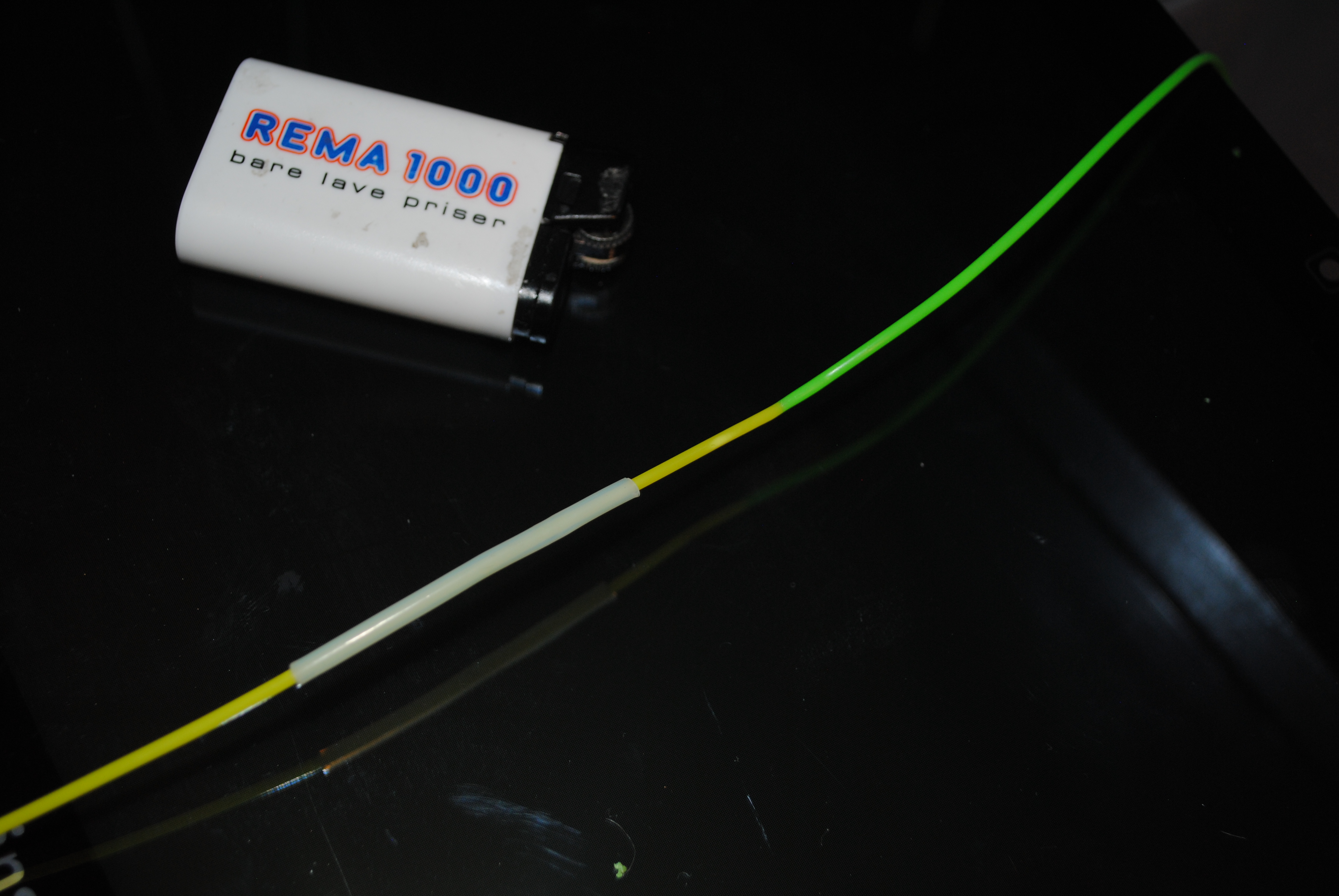

Ran almost out of filament .Had splice in a little yellow
Ok, I’ll bite: Please describe your splicing technique. I see a lighter and possibly some heatshrink tubing? Is that 1.75mm or ~3mm filament?
I suspect that is PTFE tube, filament + PTFE tube + lighter…
1.75mm ABS and 2mm teflon tubing.Just push both ends in to the tubing and heat with a lighter .Only works on ABS .
Good job. I did it like this in the beginning, too. Now I pause the print and change the filament.
