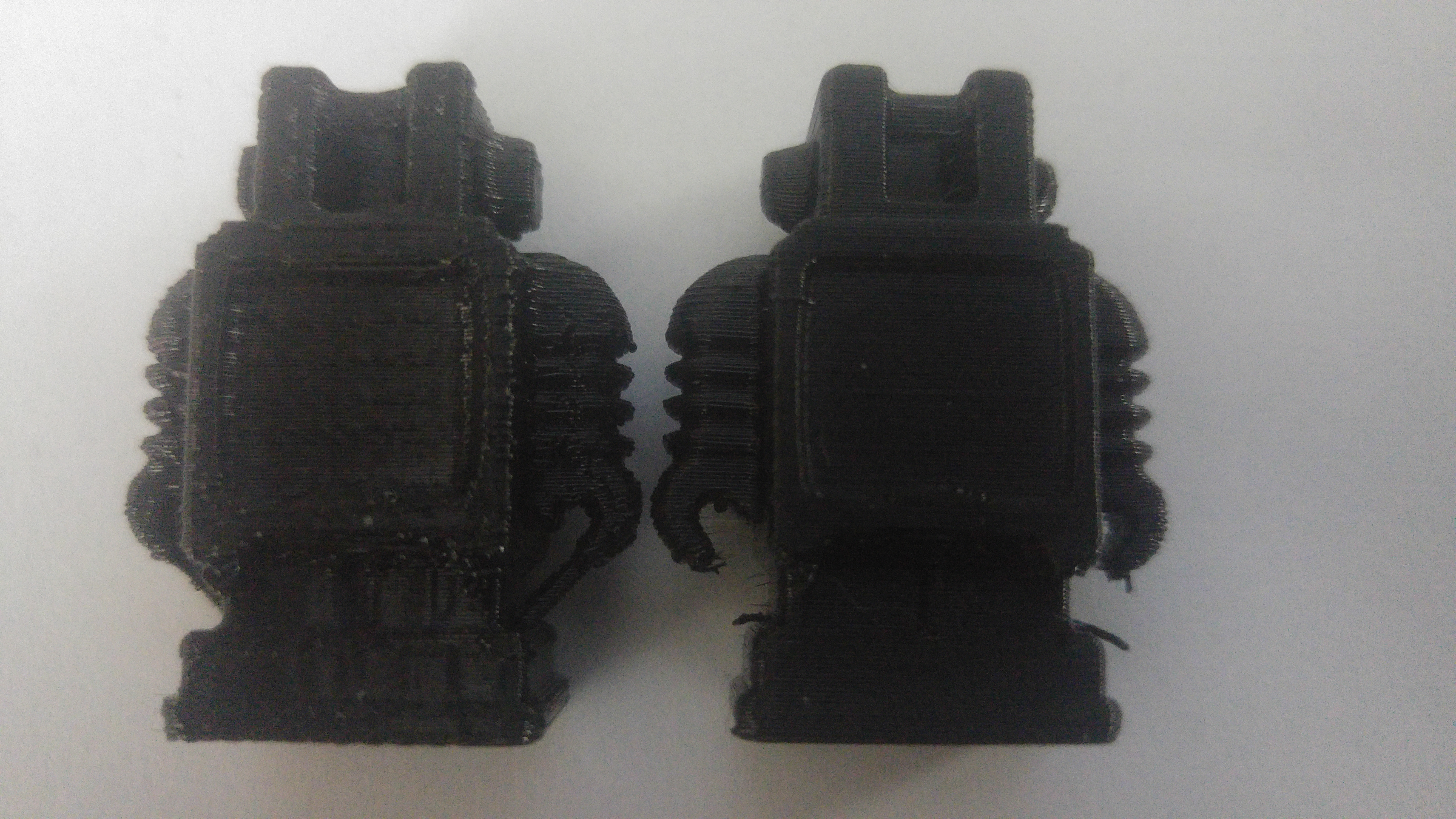

Random test (scientific-ish) between Cura, which I’ve just set up with the same settings, and Simplify3D. Left is Cura, right S3D. 80mm/s base speed with slow downs, same printer (FB2020 CoreXY), same filament, Extrudr PETG, same temperatures. I’m not saying Cura sucks balls, as I know there are a lot of people that get on with it, but I’ve either I’ve missed something in Cura or I’ve just nailed S3D well. The S3D print is by no means perfect, but it’s a hell of a lot better than Cura.

What is the difference? I mean, you should be able to tell just by looking at how it prints. Also, what is the actual time spent?
First off let me say I prefer S3D to Cura which was my old go-to slicer; but if I set my profile to 80 mm/s, my printer still only prints at a max of 27.5 mm/s for this model as shown in the movement speeds heatmap in the link below. If you adjust your print speeds in Cura to about 25 mm/s you should see comparable quality and print time. One of the many good things about S3D is that it automatically adjusts your print speed per layer of every print based off your default printing speed. So if you set your default speed to 80 mm/s you’ll still see speeds of 80 mm/s on large prints with a lot of surface area per layer yet small prints with low surface area on each layer (like this one) will still have good quality, all without changing your configs.

This may be the 1st comparison print I’ve seen that would have me look at s3d. And only because I see artefacts on the cura print that’s been bugging me on my printers for a long time.

According to the artifacts they both sucks. Both of the software use only G0 and G1 commands to represent the curves. Which means that your printer do not move in circular base but do straight movements interpolation to the desired circle. In the CNC world no one do this everyone use G2/G3 codes which means controlled curves.
I dig in to why no one use g2/g3 codes and I found that it because of the performance issues within the 8bit MCU that have hard time to calculate the controlled curve which lead to quality degradation. It will be really great we to see that changed with new 32 bit MCUs.
@George_Novtekov Ignoring for a moment the fact that you said the two slicers are incomparable then compared them, the slicers calculate curves pretty well. The precision of the slicer is certainly better than the X/Y precision of FDM printers so I don’t see why it matters.

Adam, I am not saying that they are incomparable. Just don’t blame the slicer for the defect in the print caused by your printer and your skill. S3D works because it is make it easy as by default it do optimizations in the machine code for speed to ignoring the absence of fine tuning of your machine. But machine code is machine code and if you want to compare it do it excluding the errors within the printer and the print settings like speed, acceleration and jerking.
Also what you stated for slicer resolution just do not make any sense. It is not matter of an resolution but how you generate the machine code. Every circle need to be segmented to straight lines. Every line will be separate command to the printer so if you segment it to a single stepper move you will flood your controller by far. So what I manage to find over the forums is that circles are segmented up to few hundred segments depending on the dimensions. In most cases between 200-300 segments for something between 30-50 mm in diameter. Consider that this segments could be generated differently along the different layers for example in a cone you will be able in a perfect print to see the artifacts. For example human eye is capable to detect surface variation like scratches way bellow 0.1mm.
