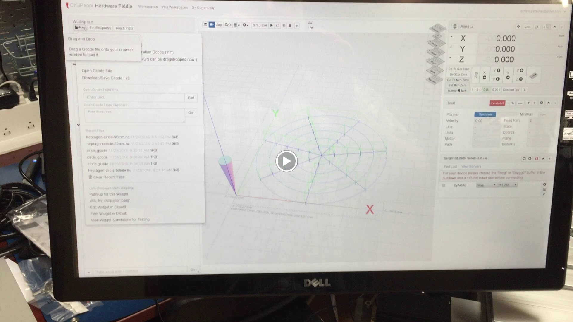

Raspberry Pi 3 with a 21.5" capacitive touch LCD, booting directly to chilipeppr via chromium. Need to fix the 3D view gesture input, and disable info tooltips on buttons, but everything else works as expected!
Put this in your Javascript to remove all popovers. Only do this a few seconds after the workspace is loaded to make sure all popover creation is completed, and thus your destroy will correctly take effect.
$(’[data-toggle=“popover”]’).popover(‘destroy’);
$(’[data-trigger=“hover”]’).popover(‘destroy’);
great, that worked nicely. I made some other tweaks and figured out the chromium tricks, and multitouch input works nicely (after upgrading to TrackballControls r82. Uploaded a video to twitter: https://twitter.com/dchote/status/802346725646200832
You can also remove the ‘btn-xs’ class from all buttons to make them bigger. That will throw off the layout probably, but would give you better touch screen size for your fingers. $(’.btn’).removeClass(‘btn-xs’);
Im going to make a pass over resizing elements later on I think. I have some overarching layout changes that i’d like to hit, but would prefer to get the CNC done first :smiley: Super pumped though, this is working out nicely
