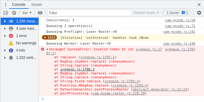

I’m using @easytarget frontend, and recently I found what may be a regression bug. I’m just dropping a PNG file on the workspace and proceed with raster GCode generation. The GCode progress bar is stuck at 98% and there is this error in Chrome developper console:
Is it a known issue?
Ok I think I know a bit what is going on.
In my GCode I have piercing function when turning on the laser in LASER TOOL ON GCODE. For that piercing, I use GCode like G1 Z-5 $INTENSITY F2000 and the raster doesn’t like this. Even if I comment out that line the GCode generator trips on it, I have to remove the line completely.

This is not realy a bug. You caused it by adding $INTENSITY in the Gcode settings. This is not supported! Why do you think you need that?
The gcode generator automatically adds the S param with the Intensity to any G1-G3 command. G0 moves automatically disable the laser. If you need another letter than S for the laser power, then just change the letter in the “LASER INTENSITY” setting.
Mill cut is ment to be used with mills (>diameter) and has the feature to mill inside or outside of a contour, where it shifts the mill for 1/2 of it’s diameter and can do depths steps. Laser cut just follows the line without any depth movement.
Just to keep track, $INTENSITY is supported since PR 473.
