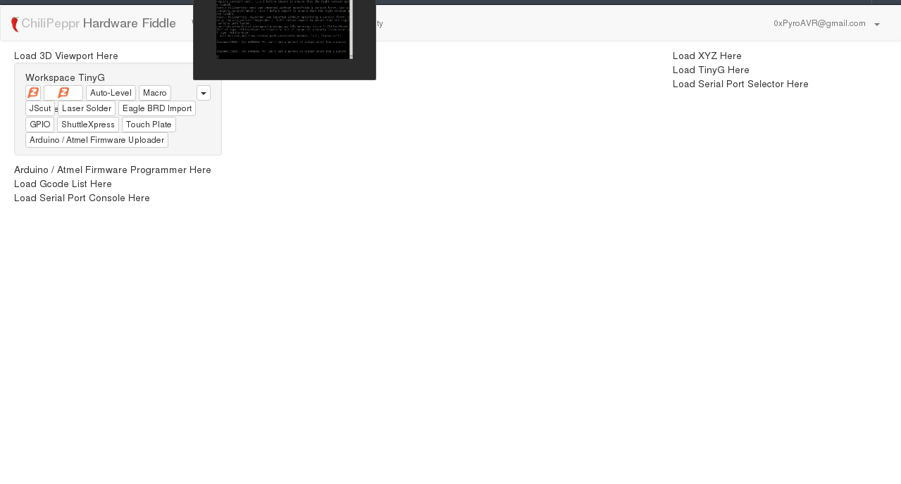

Loading an entire workspace from http://raw.githubusercontent.com is currently causing severe lack of functionality in Chilipeppr.
Now, the problem appears to stem from Github, as using services like rawgit or hosting the “auto-generated-workspace.html” file locally fix the problem with their obvious security and efficiency drawbacks. Here’s the links that will be of interest:
