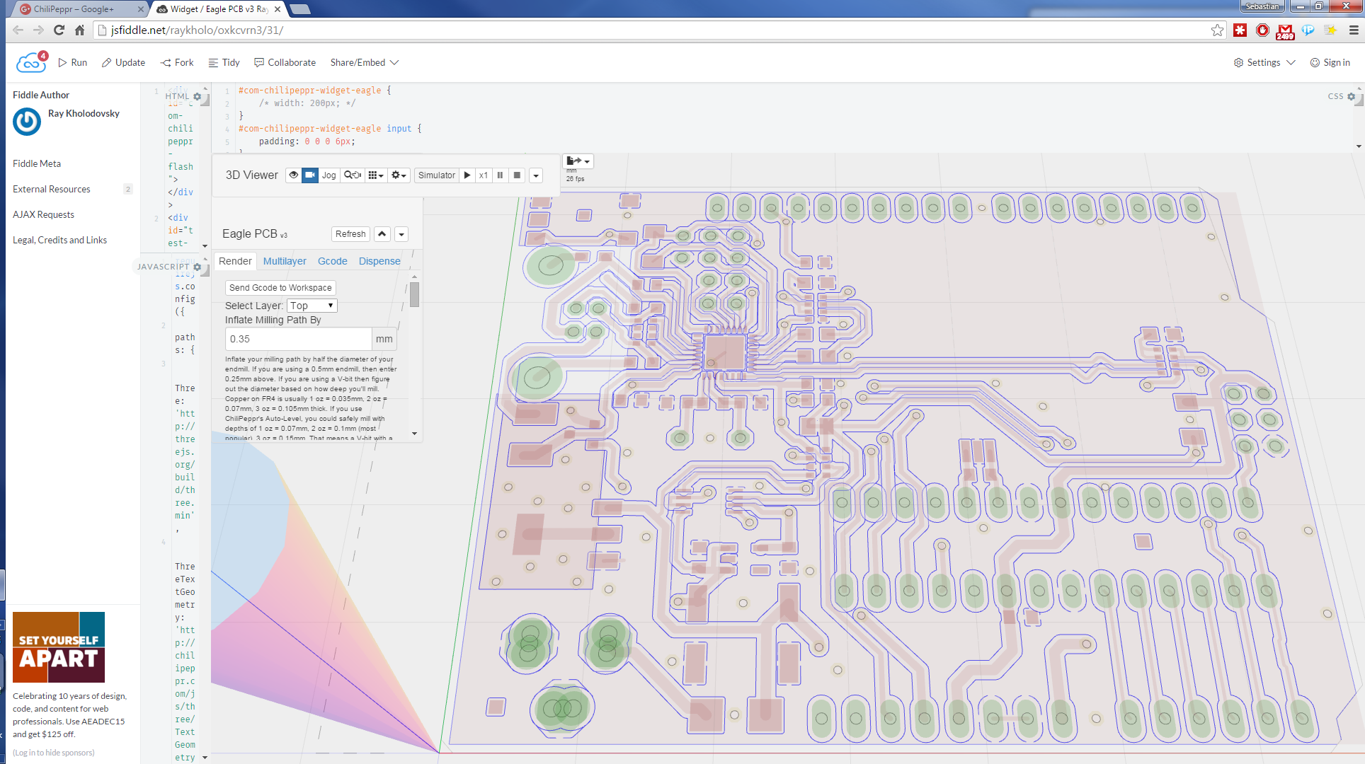

@raykholo I have attached pictures mentioned in the comment to this post: https://plus.google.com/+RayKholodovsky/posts/So8wMFFUGkQ
Pic. 1 (widget) and pic. 2 (Eagle) is the Top layer.
Pic 3 (widget) and pic. 4 (Eagle) is the Bottom layer.
Pic5 is the Eagle Top + Bottom displayed together, probably not needed here.
This is just a screenshot and the quality is not perfect when resizing picture preview, but you may see that some traces are overlapped with pads or other traces.
@sszafran thanks for the snapshots. I don’t see any traces overlapping. I do see the blue outlines around them overlapping. Set the inflation distance from 0.35 to something smaller like 0.15 and try again. Let me know if it persists.
I also noticed that round smd pads are square at the moment. I know you are still working on it. I just wanted to let you know in case you didn’t see it yet.
@raykholo Right, I used default inflate value of 0.35 previously. Today I rendered both Top and Bottom layers with 0.15 inflate milling path and it looks really nice. I was using release 4 this time. Time to give it a test on CNC, at least the Top layer.
