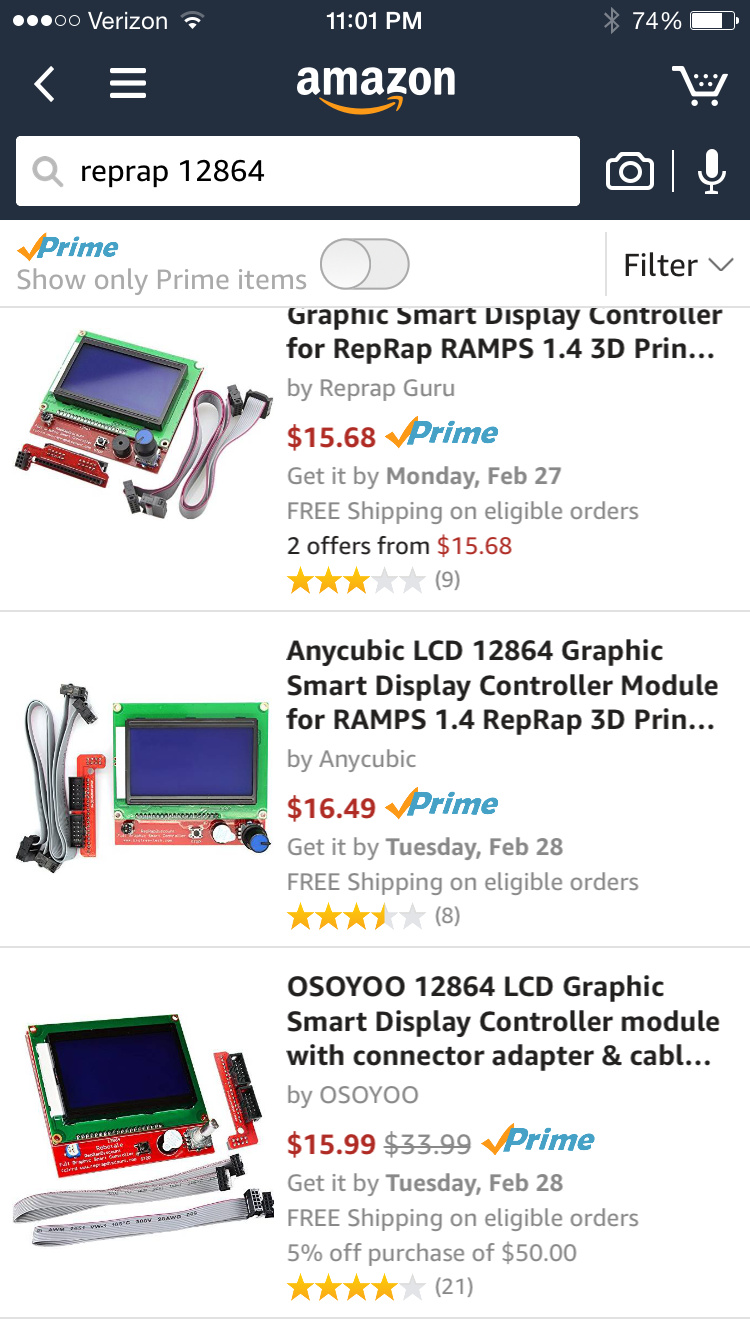

And as I may have mentioned I recommend the GLCD adapter so that you can use a “reprap glcd 12864” which you can get on Amazon.
We also carry endstops if you need those for your large build.
Thanks, its as I thought- I need almost everything you make motion control wise. Ordering now…but I see many GLCDs most of which say for RAMPS…do I need a specific one or not?
