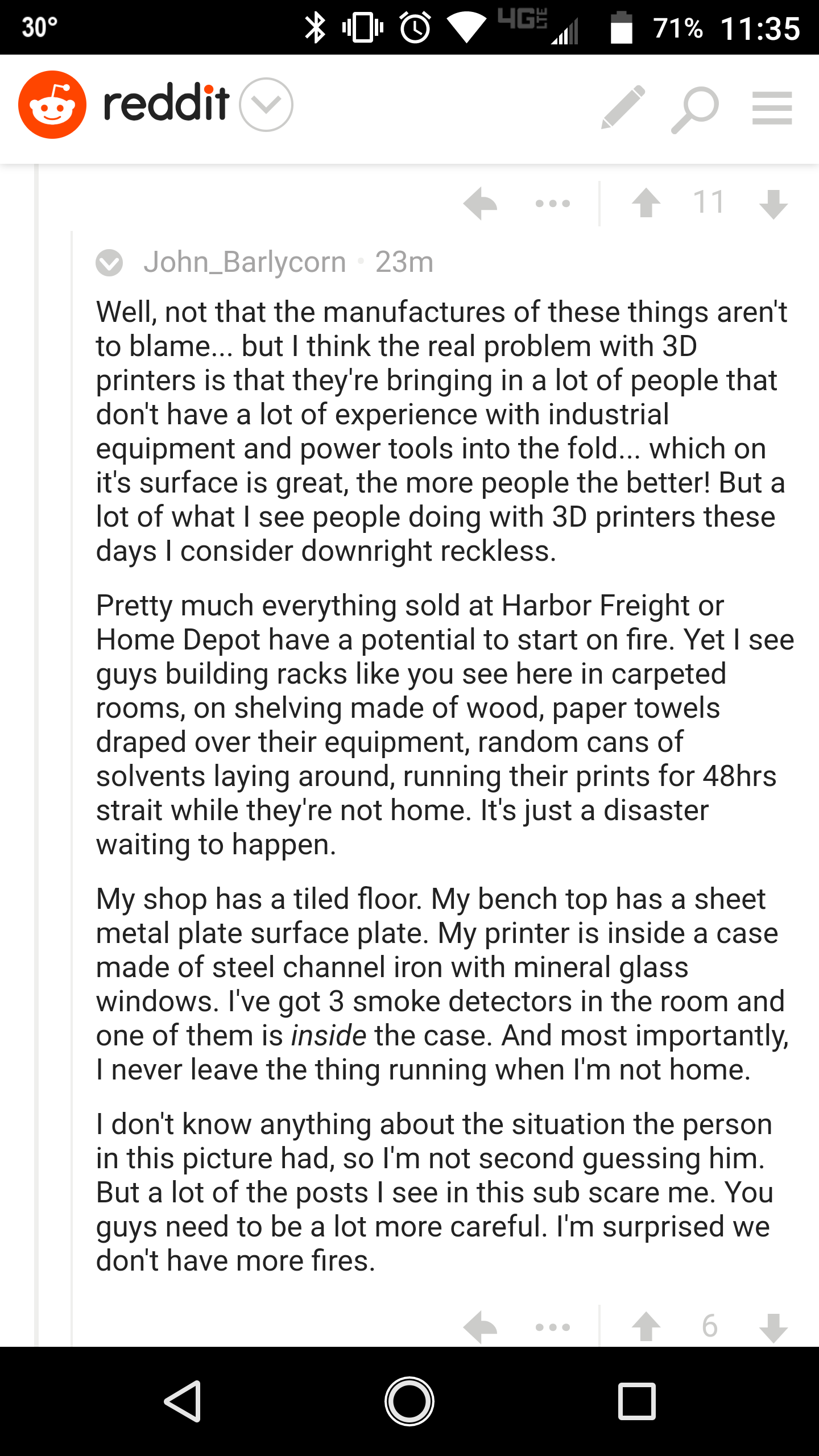

Reading through a previously posted article about another Anet A8 fire,
Reading through a previously posted article about another Anet A8 fire, I found this comment. This guy clearly has safety in mind but I’m sure there are plenty of idiots that don’t. If you are new to printing or just aren’t aware of potential risks, do some research. Learn how to prevent your house from burning down. You can take some of the steps this guy has but you can also do things like installing mosfets to reduce the load on your board. Make sure you have adequate cooling. Make sure your PSU is rated above what the printer can draw. Replace any crappy or thin wires. Make sure the screws that hold wires in place are tight! Loose screws will incorporate more resistance than your printer was designed to handle and can start fires. There are so many ways to help prevent fires. Everyone be safe! If any of the long time vets here have any additional suggestions on how to be safe, make sure to comment!

Not all that safe, I bet he still prints in an oxygen environment. You only need heat fuel and oxygen for a fire. LOL
