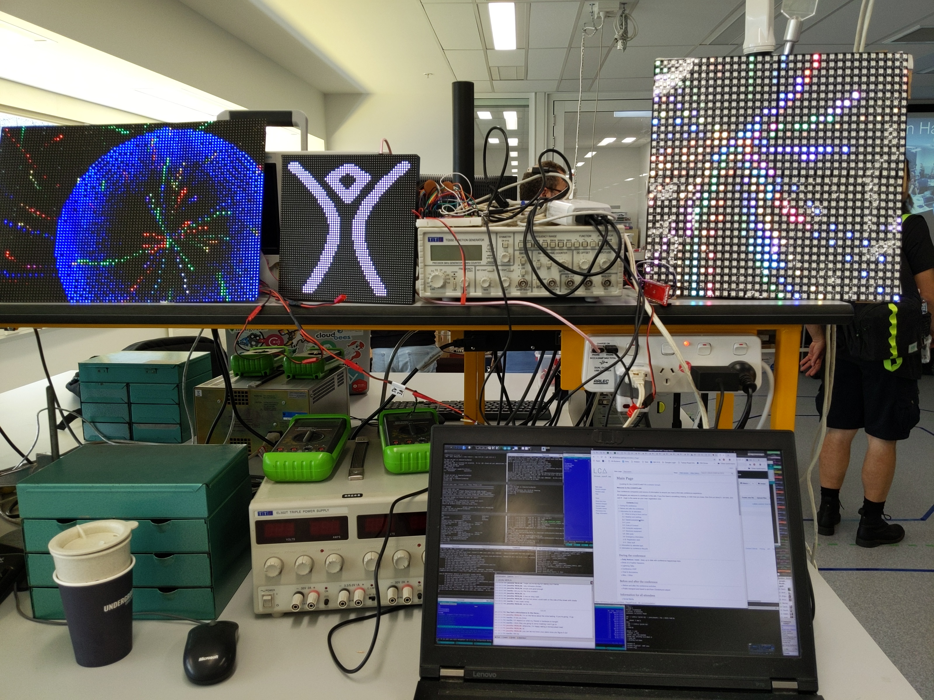

Ready for my own hardware miniconf talk at http://linux.conf.au in New Zealand.
96x64 rgbpanel, 64x64 rgbpanel, and 32x32 neomatrix (16x16x4)
running SmartMatrix::GFX on top of SmartMatrix from @Louis_Beaudoin and FastLED::NeoMatrix on top of FastLED
Sadly the RGBPanels aren’t that bright in daylight. I wish I had a way to over-amp them a bit to compensate for the scan rate duty cycle.
At the same time, the neopixels I need to run at 1/4th power or they trip my USB power supply
