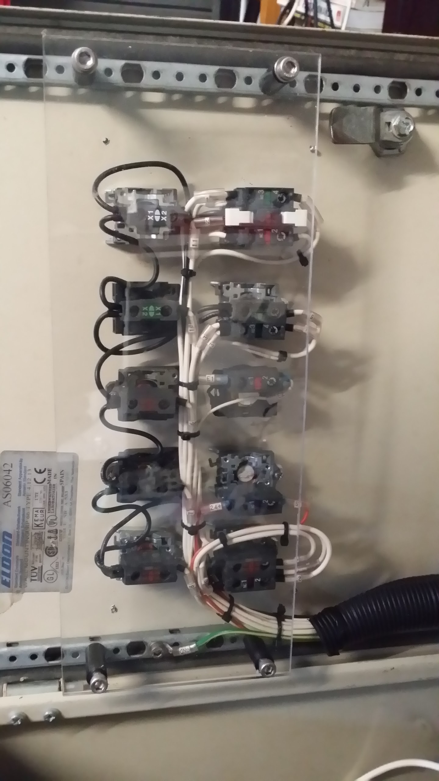

Rear view of the Machine Power Control Panel.
The perspex adds an additional safety barrier against potential electrical hazards. This is panel contains 240 volts AC and 24 volts DC. All wires a numbered and the panel door is grounded.
Hi, thanks for all the 1+'s. This project is my third CNC Control box build and I will share diagrams, suppliers etc with you peoples. My intentions are to design and build an ultra safe generic OEM power controller that can be adapted to any type of electrically powered machine. In this application it is being integrated with a breakout board, stepper drivers and power supplies to suit a CNC milling machine.
