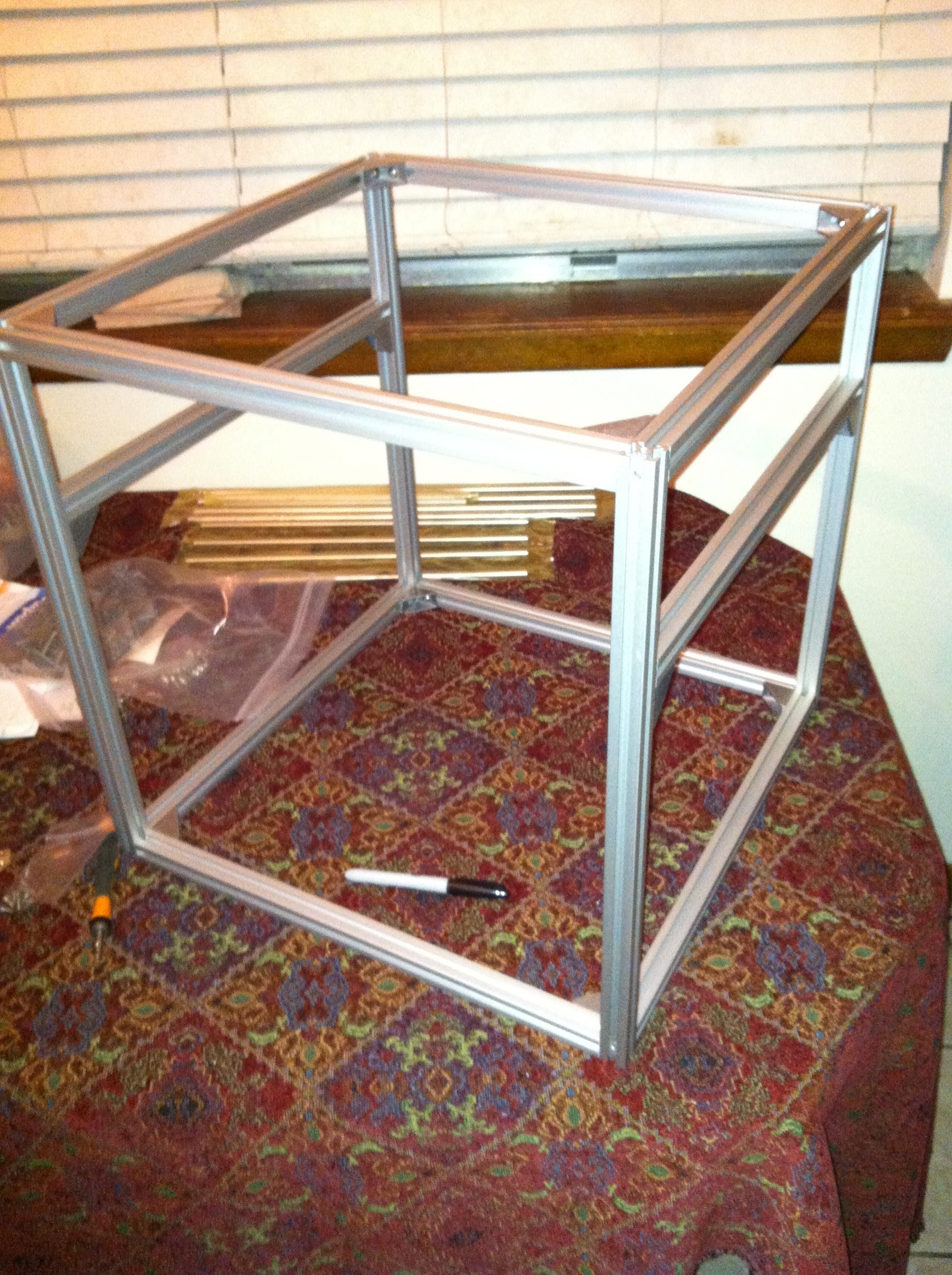

Received some of the parts. I have everything ordered but electronics, hot end, and motors .
I advise an electronics box below.you could make this from anything, mdf plywood etc. this will maximize your z for the frame size and allow you to hide stuff amd pretty it up ;- D
I got extra aluminum to make a plexiglass bottom
Cool I had an extension too but just got some extrusion to make it into one unit. I replaced the upright with longer ones and cut the extra adequate frame for inside to inside cross pieces

In order to reuse parts, I’m going with a core xy, which can be easily configured back to a standard Cartesian if I run into to many problems. The Ingentis would require all new linear motion parts. My MISUMI box is sized to match the linear motion parts of the Eventorbot, in order to reuse my parts.
As much as I’d love to build an Ingentis, the differential part cost blew my budget. After using the Makerbot with its standard Cartesian and heavy gantry, I figure as a worst case, it’s not that bad. Changing a Cartesian to a Bowden reduces weight even more, then switching to core xy is even more weight removed, so I figure I should approach the speed of the Ultimaker style printer. I also opted for gt2 belts as 3dprinterhell ran into lots of issues trying to use spectra with core xy/ hbots.
So given my constraints of party reuse, I’m designing my own printer… which is taking forever, since I design mechanical machines at work, it’s generally the last thing I want to do when I get home :-. But the fact that I got the MISUMI frame built, and am purchasing other parts, will hopefully force me to complete my design. In the Eventorbot forums, I named my printer the Millennium Falcon, because had so many hacks. I figure I need to rename it with the new design…
