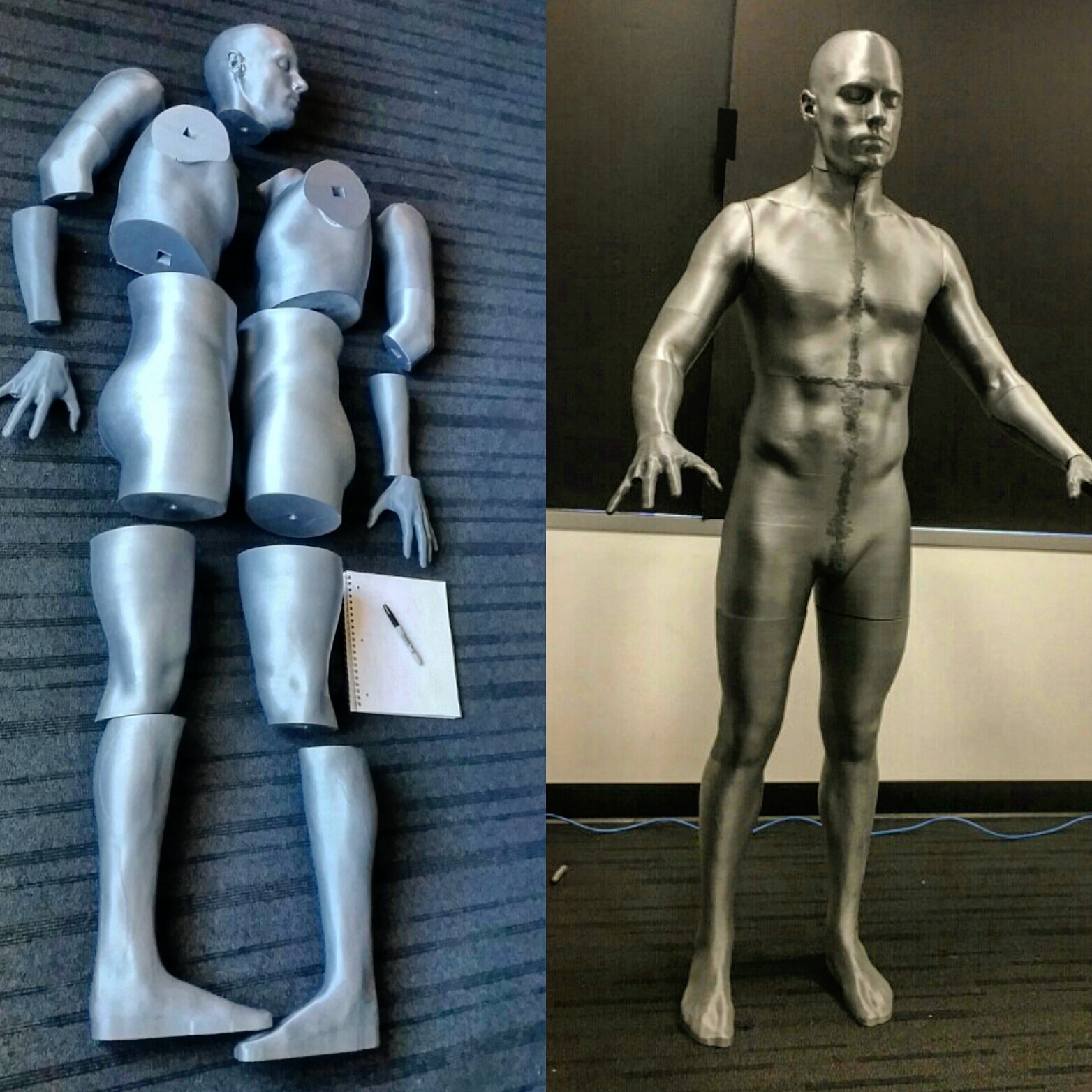

Recent R&D project: Life-sized 3d printed mannequin. Used a real human 3d scan chopped up into the build volume of my modified Tevo Little Monster (+ Duet Ethernet, Bondtech, E3D Volcano @ 1.2mm). Not counting calibration and failed prints, the whole thing was printed out of 12kg of Push Plastics PETG in 5 days & 17 hours, at 600 micron. By far the biggest single thing I’ve printed, learned a lot!

@Kevin_Danger_Powers : He was was wearing some tighty-whities during the scan. But the mooseknuckle did have to be smoothed out. Still didn’t make it not weird to have a life-sized package in my printroom…

Very nice! I’d very much like to do a life size project such as this but haven’t found much information or examples. To 3D print an object this big (although in pieces), what type of polygon size/resolution would you need the figure to be? I know your print was a actual 3D scan, but could this be done with smaller character meshes and scaled higher to print this good?
In theory, I was thinking of taking a character mesh and clothing from something like DAZ3d (low mesh), import into Zbrush to modify and maybe subdivide to be a heavier mesh, and then print.
the resolution on this asset wasn’t much higher than anything else I’d normally print. Most ‘small’ prints have far more poly resolution than can actually be printed. What I tell people to do to visualize this is: In your 3d App: Set all ‘normals to face’ (or analogs term). Basically, ‘make it look faceted, not smooth’. Now, zoom the camera so that you’re viewing a roughly life-sized version of the print. what you see on-screen should be about how it will look printed (ignoring z-resolution, and xy nozzle resolution). If it looks too faceted, then smooth it more. If not, print!

On a life-size print like yours, would you recommend a .6mm print nozzle?
