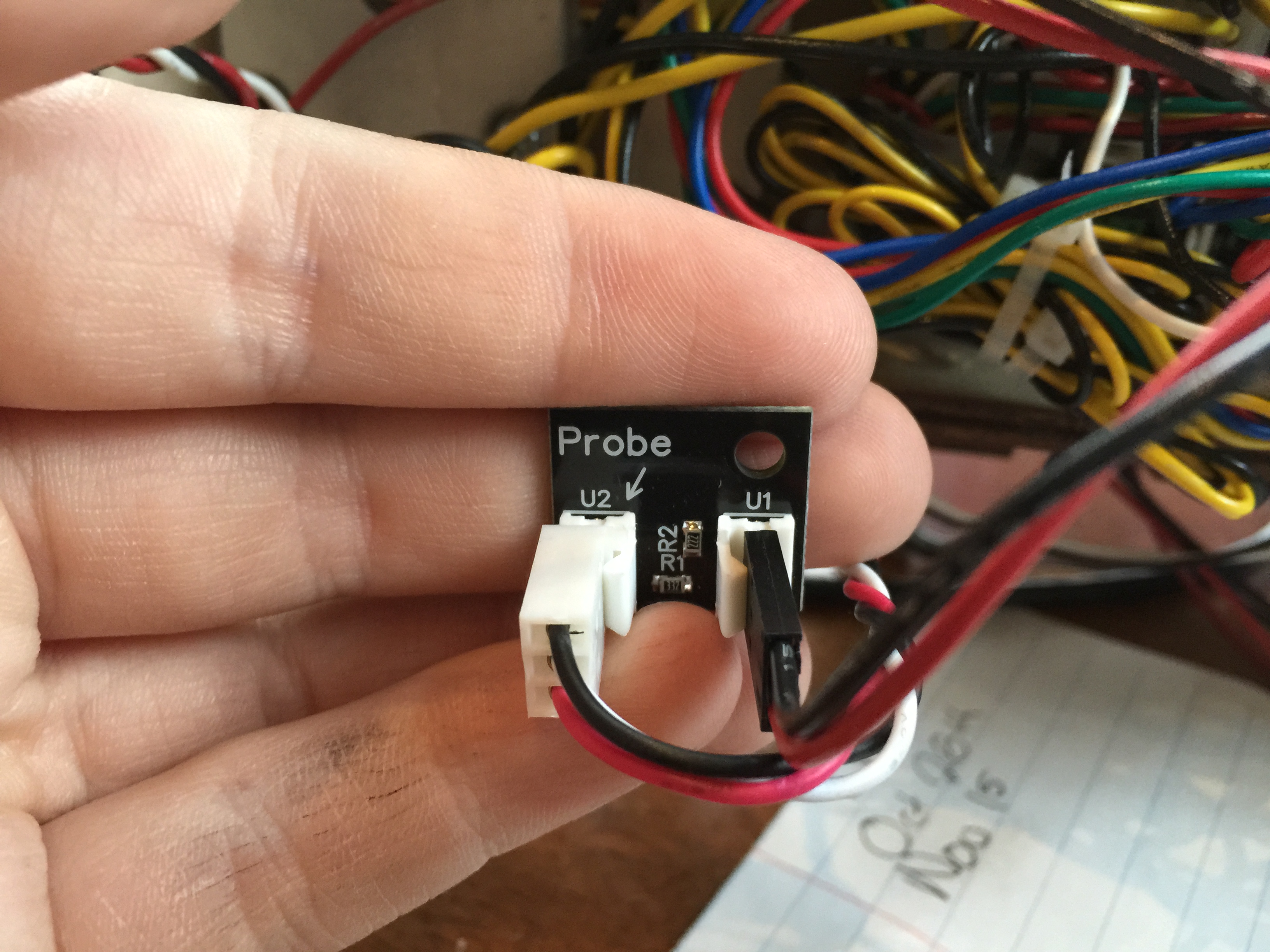

Recently I added the printrbot rev f board to my printer and added the Lassen firmware. Before I had the rev f board my printer was working fine with the induction probe. After adding the new board the probe stopped working. The rev f boards power has a smaller board that says probe but I also know the probe can be plugged right in to the board. Please help me get printing again I’m going thought withdrawal without my prints.

The light stays on when plugged into the small pcb of the power supply. When plugged into the board the light comes on when metal touches and goes off when backed away. The Lassen firmware also includes probe and the firmware has the probe turned on.
Hmmm there is a good chance a wire was reverse when you had it attached to the small pcb. Looks like a possible fried sensor.
Rev f doesn’t need the small add on pcb, the circuit is built in
