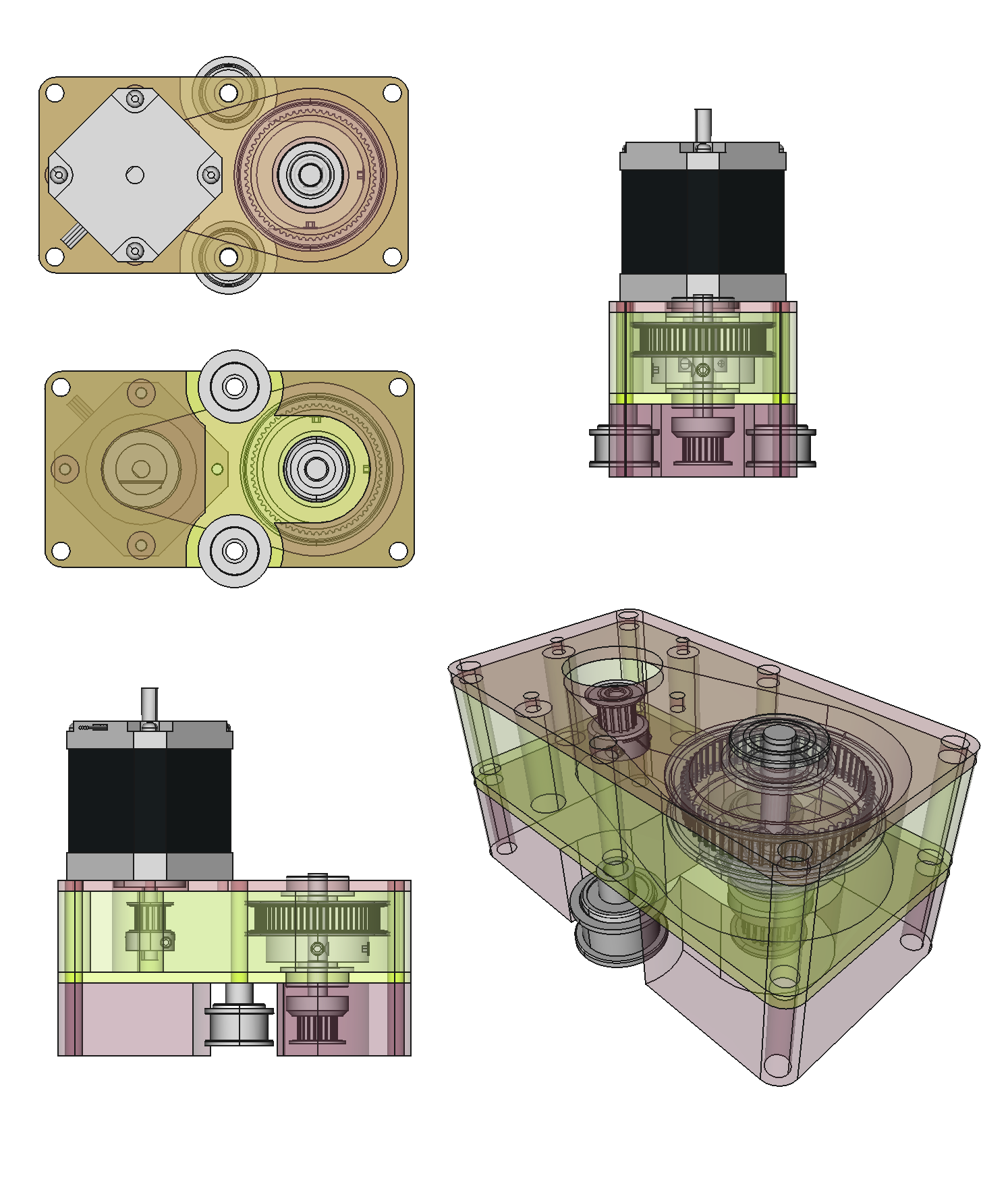

100 micron resolution with shapeoko ??!! Yes I can :D. At this point I can drive the motors with this configuration at 1000mm/min, I am happy with this since I usually cut at 400mm/min-500mm/min.
The configuration shown uses outside-belts configuration; this is not require, I design it so it can be a direct replacement to the regular stepper motors. For in-belt configuration just don’t make the idle wheel blocks. The upper screw have the NEMA23 profile and is just a direct mount or replacement for stepper motors. The pulley the drives the belt is a 20 teeth just as regular shapeoko . Without the idle wheel blocks it will look like this early prototype (https://lh6.googleusercontent.com/-BbDuItj7Znw/UuoQa1HvqWI/AAAAAAAALbk/MORKitksLl4/w878-h494-no/IMG_20140128_215425129_HDR.jpg).
Here is the measurement data at different micro stepping and pulley ratios, all are GT2 2mm pitch belts and pulleys and driven with tinyg :
1:1 No Pulley Drive: Pulley reduction drive 1:1 - Google Drive
4:1 Pulley Drive: Pulley reduction drive 4:1 - Google Drive
image: http://raw.githubusercontent.com/shapeoko/Shapeoko_Experimental/wduembeg_PulleyDrive4to1/PulleyDrive_4to1/documents/4to1_Pulley_Drive.png

This is nice. I do a lot of PCB milling and am always looking for better resolution out of Shapeoko. How much better does the torque get? I stopped doing 8x microstepping due to the reduction in torque it causes. Got any videos of it put together?
T2=4T1, One of the formulas for Torque is T=Fr, force is the same on both pulleys and the changing part is the radius. No videos yet but plans to do something in the future.
w.r.t. PCBs, That was also why I was looking for better resolution/accuracy, specially with SMD components.
BTW on all my testing I have gotten better accuracy with 2x micro stepping. with 8x or 16x the accuracy gets worse (measured and in tables provided on the original post) Also tested this on multiple setups and with different controllers (Grbl, TinyG and TinyG2). Not saying is a fact just empirical data, something to test on your setup and tune your Shapeoko for the best resolution. Originally I hypothesize it was due to losing torque never the less results where similar with the 4:1 drive, probably something else.
Another thing to take into account when it comes to higher accuracy is the specs of the motors, usually listed as 5% stepping accuracy under no load and only 10% accurate under load. This is where a feedback system will be better… but pricey. Also experimented with lead screw drive but it requires machining, and I wanted this to be a inexpensive and easy to upgrade for Shapeoko 1 and Shapeoko 2. It does require some ⅛ aluminum plates, but if you have your machine running is easy to make these parts before taking the machine apart for the upgrade.
