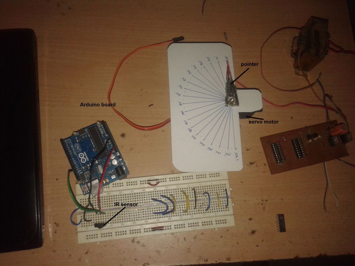

Here are some examples:
https://create.arduino.cc/projecthub/Raushancpr/servo-motor-control-with-remote-fd6d95
