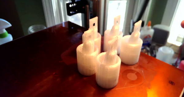

Removing ABS parts using ABS dissolved in acetone and printing on 100C bed.
Removing ABS parts using ABS dissolved in acetone and printing on 100C bed. The bed has been allowed to cool.

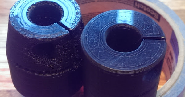

This is a photo showing the problem I was trying to address, and how well it worked:

I’ve got a sheet of PEI that needs to be tried but installing it is a non-trivial task. As it is, spreading the ABS/acetone slurry is quick fix solution and is working great so far. Just a quick wipe with some acetone on a Kimwipe between prints, and it’s good to go.
