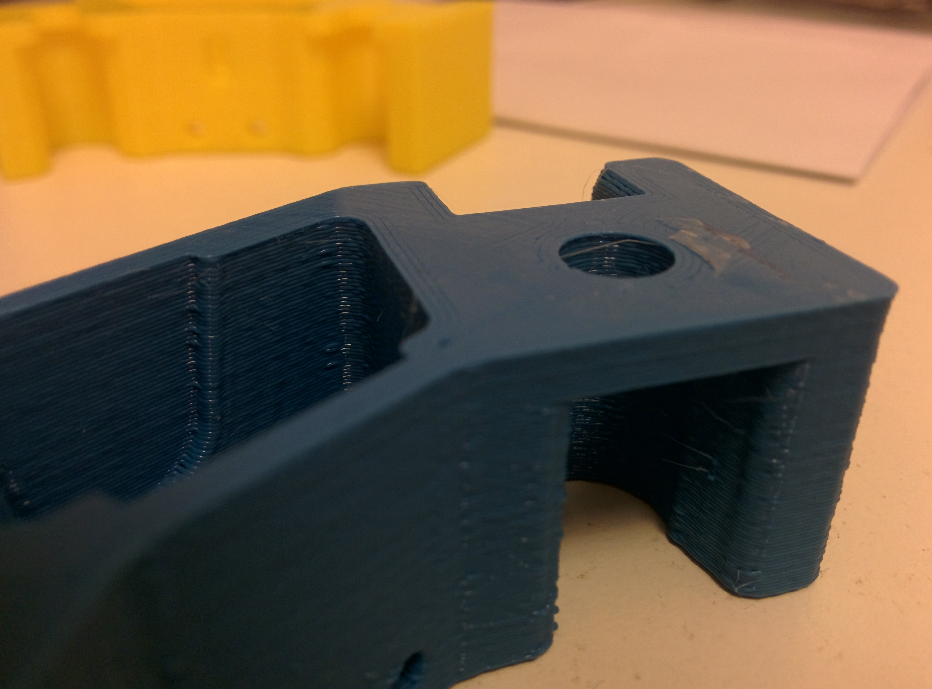

Removing pla part from glass (glued, but not so strong: I removed with hands),
Removing pla part from glass (glued, but not so strong: I removed with hands), a part of glass was removed too! Did it ever happens to you?!
