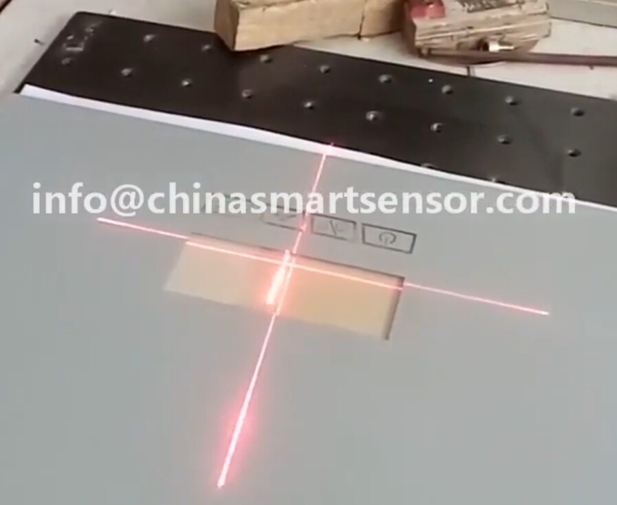

Hello. I need some help with chossing the right type of laser. I need to remove silver from behind the mirror so that mirror is transparent. I need to do that so i can install touch sensor on the mirror. Can someone help me with what type of laser i need. Thanks in advance.

Thank you. So the mirror is completly transparent, it isnt frosted? I need to look like in this picture.
It didnt frost when I did it. I dont believe diode lasers are capable of frosting glass (although its been a long time since I used Diode).
I would suggest waiting for other replies before investing in the hardware.
Ok thank you, i uplouded a picture in post above, so you can see what i am talking about.
