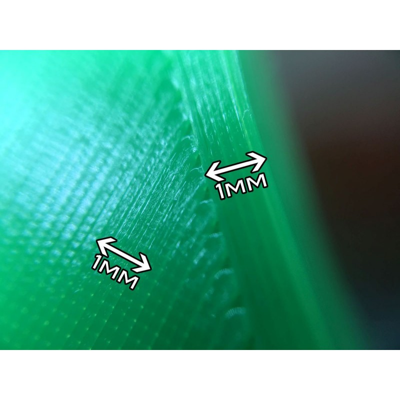

Do you have an example of a petg print for comparison?

@peter_rowser PETG with my 0.2mm nozzle.
Well that just made green with envy. Very detailed example, thank you. Wow
