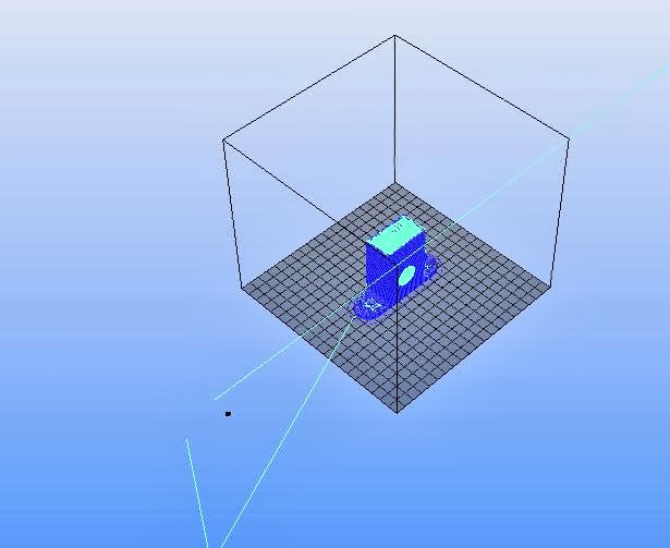

Repetier host issues: see picture Finally got the Elefu Ra working for manual control
Finally got the Elefu Ra working for manual control of all axis (after a week of not touching it), homing correctly, etc. I thought I had Repetier setup appropriately as well, but the black dot centerpoint just made the printer try to print where the axis don’t reach. Anyone know how to fix this? (mendel 90, z limit switch at top)
repetier print settings
X and Y min need to be 0. X/Y max need to be 200. Bed Left and Bed Front also need to be 0. And, you’re homing your Z to the max endstop? Is there a reason for this?
I home to Z because that is the design choice made by @nop_head - it eliminates any risk of bed crashing, and I like it from a mechanical layout perspective. Thanks!
Ah, good stuff. You didn’t mention what printer it was, so pretty easy to just assume you accidentally switched it or something.
