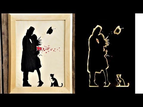

@Nedman I wonder if your could use an acrylic layer instead of the LED’s under the profile. Etch a profile in the acrylic so it is positioned at the edge of the profile of the wood?
I would go for other kind of light.
like this one :
http://www.ebay.co.uk/itm/Neon-LED-String-Strip-Light-Glow-EL-Wire-Rope-Tube-Car-Dance-Party-Controller-/382086328216?var&hash=item58f61eaf98:m:myMF6n8plAMAePCWfBYVceA
@StephaneBUISSON I think that’s a better choice of lights than the string the author used.
I was also trying to avoid all the routing for wires, gluing etc.
Bolt layers together like this:
… Dark wood background layer
… Acrylic layer with etched silhouette slightly displaced from the next layer
… Laser cut wood silhouette
Light the acrylic from the edge with LED string. This method may not create enough light?
