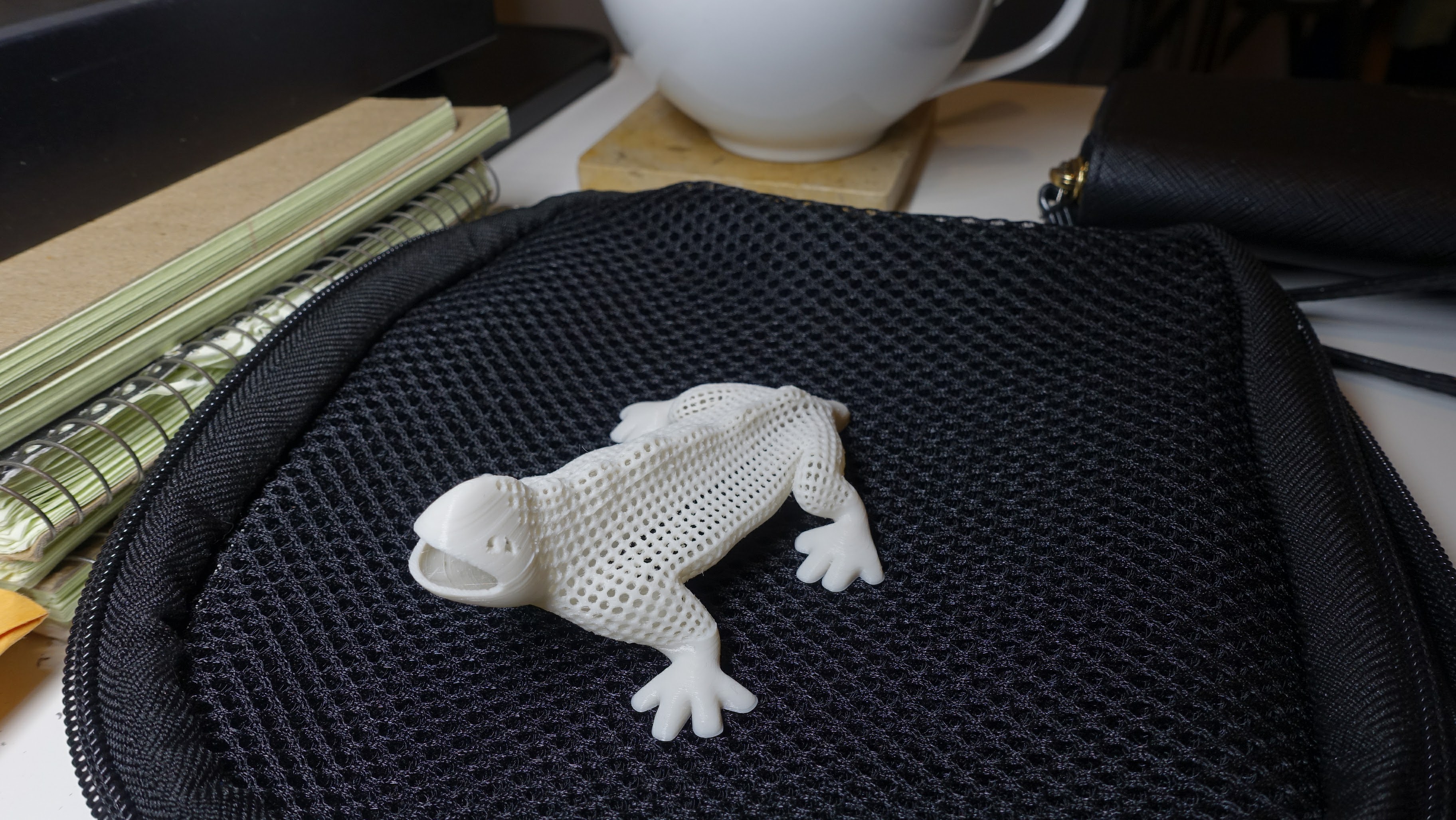

Replace titan with Bondtech BMG Bowden setup retraction torture test and also first print. This stuff is magical.

I sliced this one with Prusa slic3r notable setting:
- nozzle 0.25mm E3D
- retract 33mm/s length 6.8mm (E3D v6 lite)
- print speed 40mm/s but spent most of its time doing small islands at 12mm/s. This is my primary reason to slice with slic3r because S3D can’t do this
- Meltink PLA 210c
link to STL http://www.thingiverse.com/thing:948565

This hollow operation of the object, the middle does not need mold pad up? The upper layer will not collapse phenomenon?
