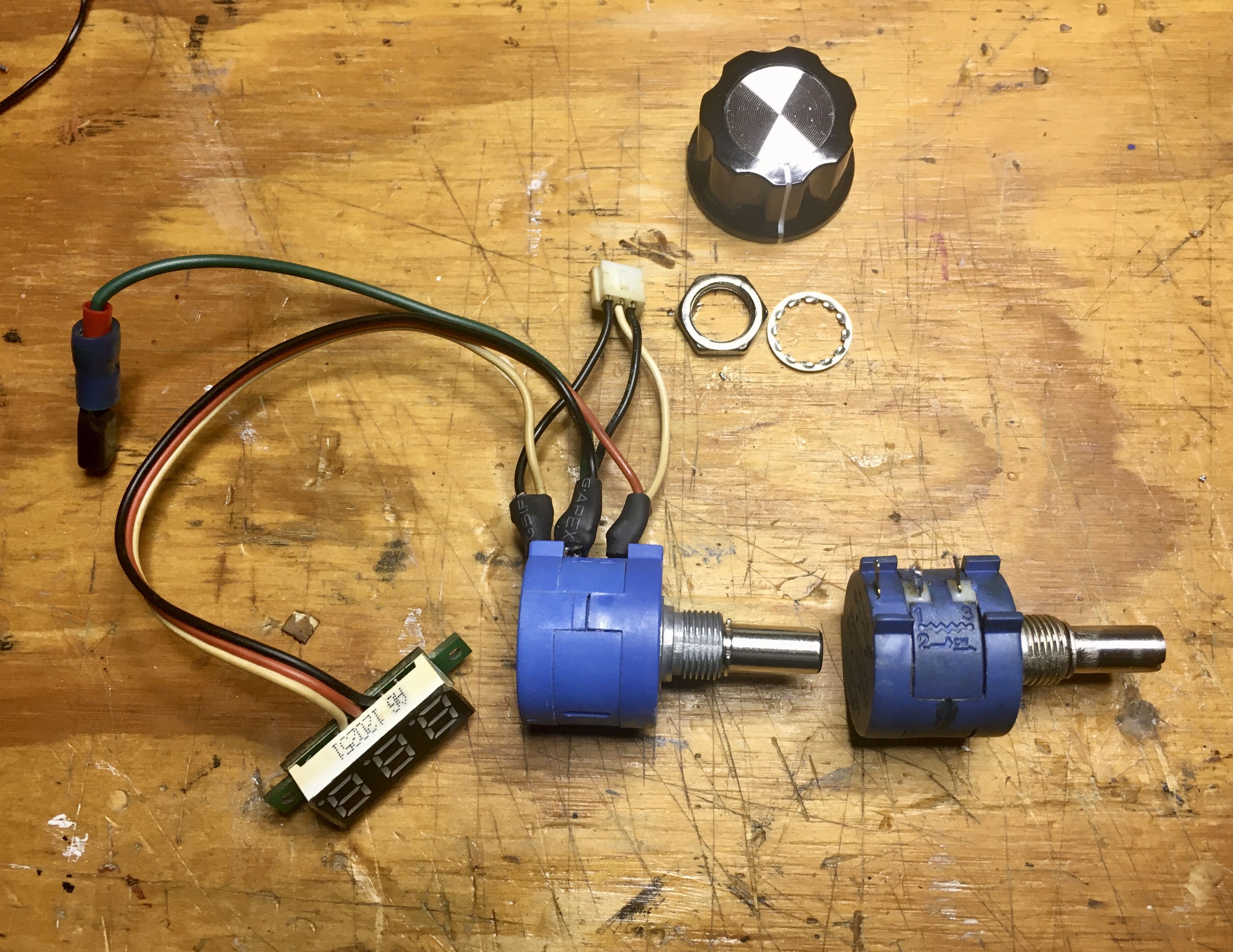

So a couple of years ago now (time files) I “upgraded” from the digital control on my K40 to analog control with amp meter and power pot. The power pot is a multi turn 5K ohm variable resistor recommend by @donkjr .
I use my k40 quite a bit and I’ve recently noticed that the voltage I measure across the pot, to determine a power setting, was bouncing around a lot when I turned the knob for the pot. Hooked up my meter and the pot was very noisy with the resistance bouncing around quite a bit. So it was obviously time to replace the pot.
Could not find a listing for a single pot like I originally bought so I bought this 2 pkg that came with knobs and now have a back up.
https://www.amazon.com/Taiss-Precision-Potentiometer-Adjustable-3590S-2-502L/dp/B07D81HLCW?dchild=1&keywords=5k+10+turn+pot&qid=1617747789&s=industrial&sr=1-1-spons&psc=1&spLa=ZW5jcnlwdGVkUXVhbGlmaWVyPUEzTVVZUTRIQ0lWMlJQJmVuY3J5cHRlZElkPUEwNDUzNzc1SEdRQk1LOTlKSUhBJmVuY3J5cHRlZEFkSWQ9QTA3MTc1MDMxNENZUk40UVpIQjBSJndpZGdldE5hbWU9c3BfYXRmJmFjdGlvbj1jbGlja1JlZGlyZWN0JmRvTm90TG9nQ2xpY2s9dHJ1ZQ%3D%3D&linkCode=sl1&tag=donsthings-20&linkId=0c1158a2cf8aa82f0d64bd6ff25be50a&language=en_US&ref_=as_li_ss_tl
Easy fix with unsoldering and re-soldering some wires.
Much better.

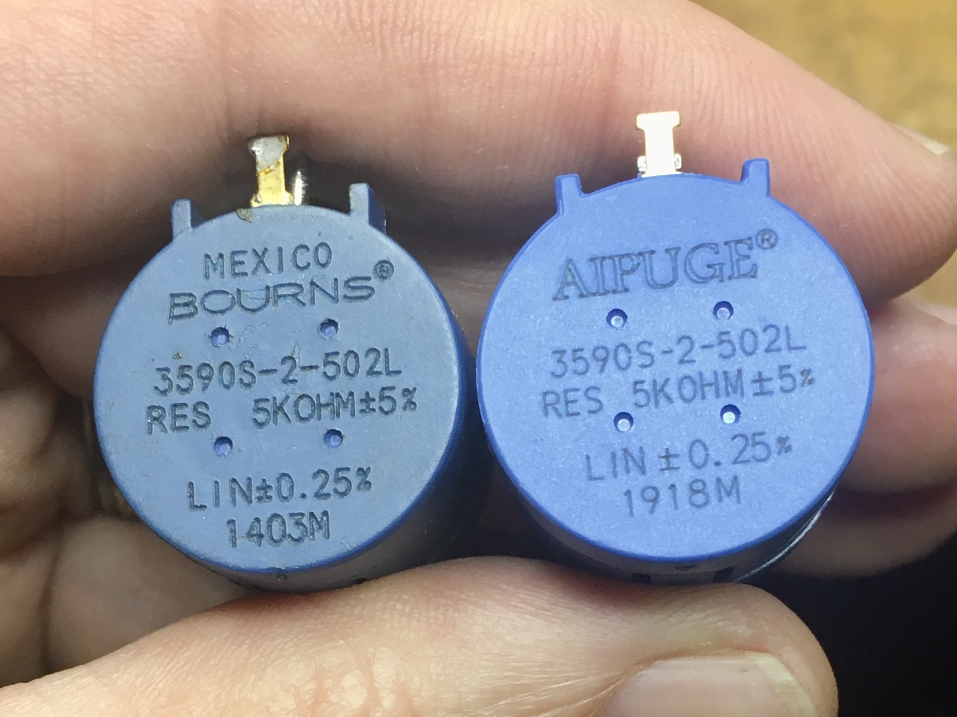

I bought one of those from Aliexpress and it’s labeled as Bourne/Made in Mexico. Bourne were always the ‘goto’ potentiometer maker during my early electronics days.

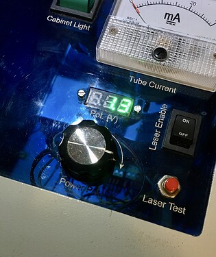

I like the voltmeter addition, might have to try that.
My old one was a Bourns and the new ones I bought are labeled as AIPUGE.
Yeah the voltmeter is great as it allows me to dial to a voltage that I know will give me a certain tube mA. Another great upgrade idea from @donkjr .
The voltmeter could be an add on for the new control panel design OR…
They will be a micro running a small touch screen as part of the control panel update,( looking after temperature , interlocks etc,) Perhaps I could have the micro monitor the voltage and display it as a mA reading
(no Geoff, finish re-building the damn laser first!)
The challenge with displaying a MA value relative to the 0-5V control voltage is that the V vs I curve changes as the tube wears.
I have thought about automating the laser current setup. The user enters the current needed and the controller runs a calibration program to find and set the right control voltage.
