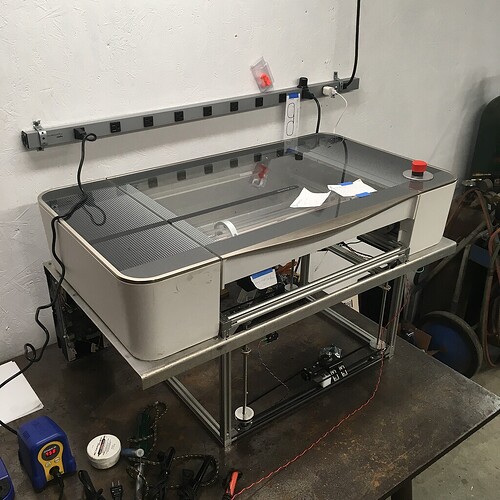

Thus the reason I gutted the machine and replaced with open source parts and software.
Although quite time consuming it allows me to maintain the machine with available parts.
That’s the beauty of the K40 … so many parts sources and community support.
