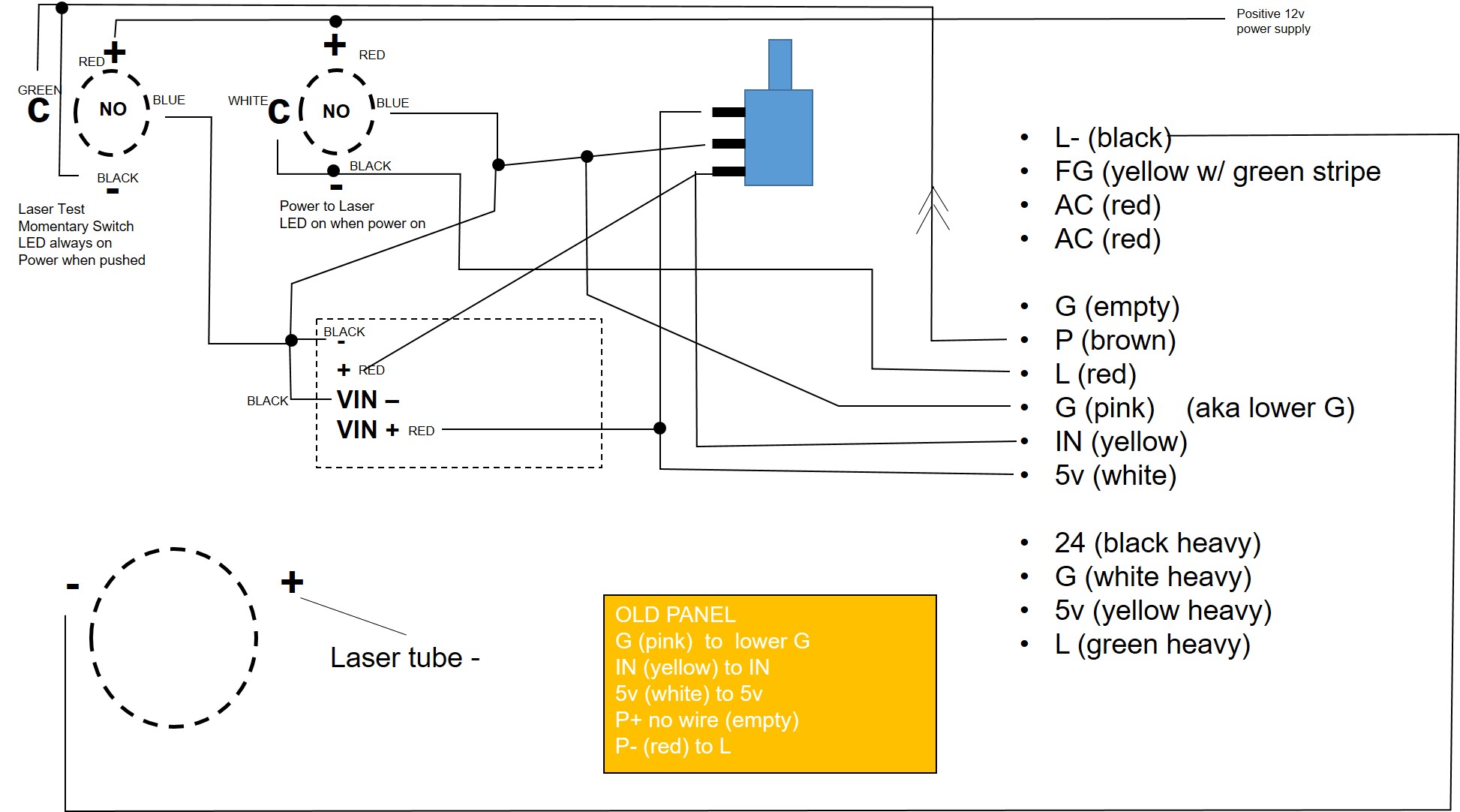

Current wire diagram (with location for future interlocks)
Some clarification is needed:
Since all the wires that were connected to P were removed, I assume that means that the Black and Green wires coming from the Enable Switch are not connected to anything
in #7 you say that:
… how can the Enable LED come on if the BLK (LED-) is not connected to anything??

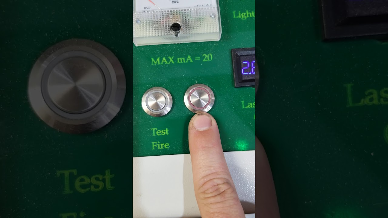

Sir, please check out this quick video. Hopefully this will be a little bit clearer.
Also, as referenced in the video, I have this Multimeter coming on Wednesday to replace my 30 year old POS meter.
The video does not play?
You’ll have to click on the youtube link in the upper left hand corner. It’ll open in youtube and play.
I changed the settings. Maybe this will work now…
Thanks for the video and sorry it took me a day to get back.
I am replacing my roof so its kinda crazy here.
Am I losing it?
Is the switch that you show in the video actually the Laser Fire (left side of the panel) that you are saying was connected to the P? (GRN-BLK-BRN connection)
The Laser ON switch (alt action) should be connected to P?
In the video the labeling is Laser Fire is on the left and the Laser ON is on the right correct?
Are these switches reversed?
According to the amazon drawing, the only white wire is on the push button (which should be the Laser Fire) and in the video that is on the right???
The wire colors do not seem to match what the amazon spec says for these switches? I do not see a yellow wire anywhere which should be on the Switch ???

The laser enable switch should connect G and P when active. The laser test button should connect G and L when pushed. If that works, go figgure out the button lights.
I also think we may need to verify that the information we have on the switch and PB connections is correct.
I agree with @cprezzi
After we resolve my questions above regarding switch positions:
Disconnect both LEDs and only wire the switch/pb to the LPS as the previous schematic shows.
  • That means on the Laser On sw disconnect the Red and Blk wire
  • On the Laser Fire disconnect the Red and Black wire.

Exactly. From your video I can see that the left button is connected to P, whch is enable, not test fire! If this is the momentary button for test fire, you need to connect it to L and the right button (on/off) should go to P.
You have the two switches reversed…
Does this make sense???
I switched the wires so that the Left button (test fire) is connected to L, and the right button (enable) is connected to P, and the same thing happens. When I engage the Enable button (right) it fires the laser consistently until I disengage the switch. When I press the test fire (left) switch, regardless of whether or not the enable switch is engaged, it will fire the laser.
When I run lightburn and execute a cut, it will still run with the Enable switch in the off position.

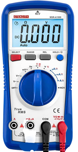

I did get the meter. When you say “ground P and measure L” does that mean you stick the black end of the meter on P and the red end on L? vice versa when “ground L and measure P”
Let’s try it the easy way first.
Set your meter up this way:
Note the placement of the black and red leads.
Meter check
Connect:
Red lead to the Black lead
  1. What does the display read & post a picture of the meter taken while measuring
    -It should read 0 ohms meaning the meter is set up correctly.
EDIT: you need to ensure the display shows an ohms symbol at the top.
you may have to use the “select” or another button to get to that mode.

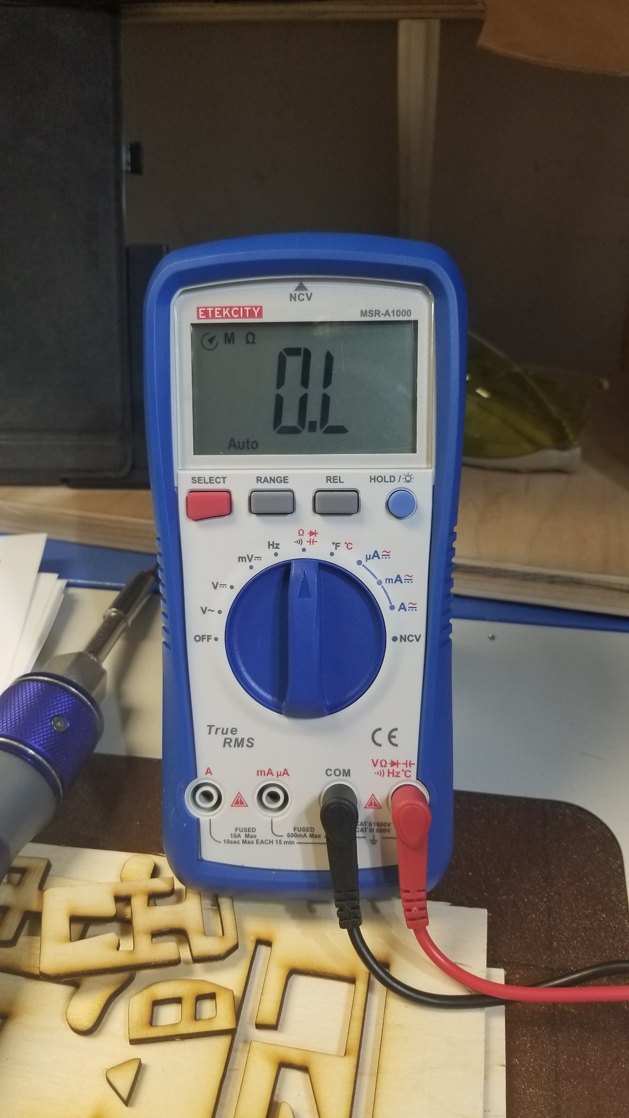

Hello. Sorry it took me a couple days to get back. Had some other issues come up that took precedence.
  1. This is a picture of when I touched the two leads together. They had random readings when I initially touched them together, but eventually they zeroed out (after about three seconds).
I then unplugged everything from the LPS.
  1. Initially, when I touched the Red to the P and the Black to the L, this is what I got.
  1. Then when I connected the Red to the L and the Black to the P, it didn’t read anything. It just displayed 0.L
Then when I went back to Red lead to P and Black lead to L, it displayed 0.L.
Something is not right.
  1. when you short the meter leads it should read 0.0 not O.L which means it does not see the leads touching.? We must have the meter in the wrong mode or something?
