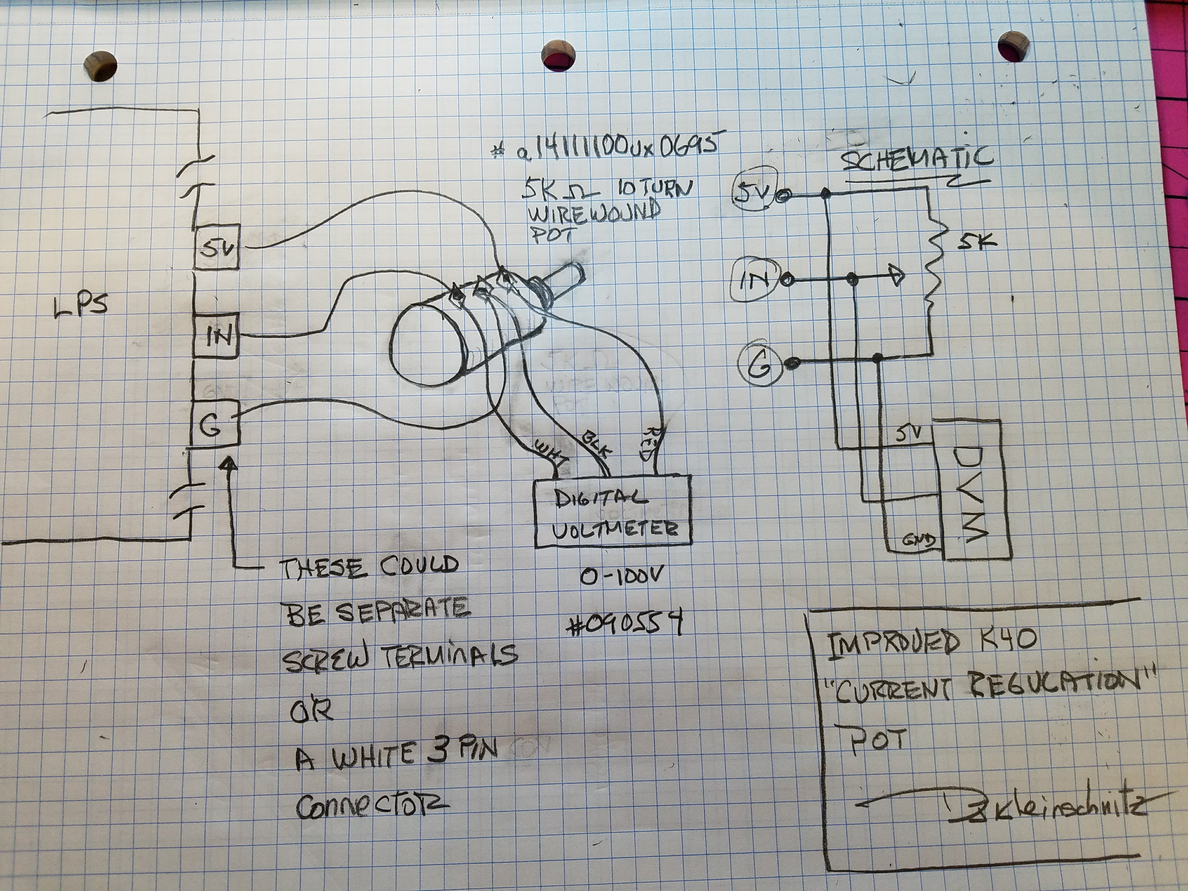

Can you post pictures of the pot and digital display or link us to the purchase site?
Hello Don, thank you for your assistance.
For the digital display, I bought it off of Ebay, here is the link: https://www.ebay.com/itm/Blue-LED-5-Digit-DC-0-4-3000-33-000V-Digital-Voltmeter-Voltage-Meter-Car-Panel/312907261280?ssPageName=STRK%3AMEBIDX%3AIT&_trksid=p2057872.m2749.l2649
And for the pot, I bought it off of Amazon (because the one I bought off of Ebay shipped back in early April and still isn’t here): https://www.amazon.com/gp/product/B07DG29QDY/ref=ppx_yo_dt_b_asin_title_o06_s00?ie=UTF8&psc=1
Thank you Sir.
Attached is a generic picture of the wiring.
To be more specific I would need:
  • A picture of the connections on your LPS
  • A close-up picture of the solder posts on the pot with the diagram of the resistor showing.
    ** As the attached picture shows these pots often have the “wiper” on the bottom unlike other pots where it is located in the middle.
  • More information on the digital meter as the ebay link doesn’t define the connections.
    ** i.e. there are two plugs but its unclear which is power and which are measurement inputs.
    ** Generally there should be a pair that powers the meter and another pair that connects to the load.
    ** The spec on the meter is also confusing “DC 0-4.3000-33.000V”. Is that 0- 4.3V or 0-33V or what :upside_down_face:? Perhaps it depends on how it is hooked up.
FYI: This is the type of meter I used and shown in the attached picture: 0.28" Red LED DC 0-100V 3 Wires Digital Voltmeter Display Voltage Panel Meter | eBay
This looks like the same/similiar meter and has more information.
If this is the same meter then I would guess the following:
Power+ >> LPS 5v
Power- >> LPS gnd
VIN+ >> the pots wiper
VIN- >> LPS gnd

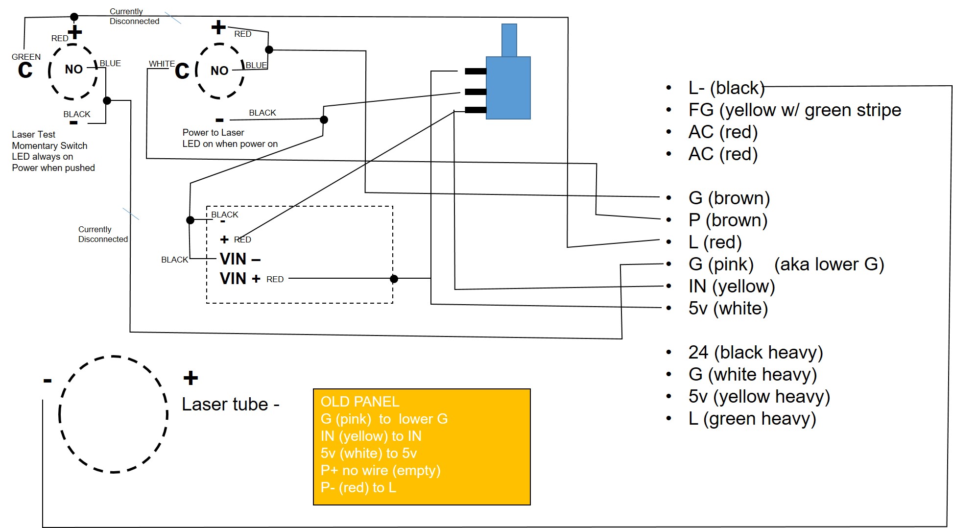

Hello Sir. This was extremely helpful as I was able to get my POT and digital display setup. Mine is exactly like yours, except blue and not red.
I’m now having problems with my buttons. I’m not sure the Laser Activate (power to the laser) and my test fire momentary switch are wired properly. I’ve attached a diagram of how I have everything currently.
I have disconnected my laser test switch because I don’t think it was hooked up correctly. I’m not sure my Power to laser switch is correct either.
For my test switch, I have a momentary push button. I would like to have the LED on all the time, but only power when I push it. Not sure I had it wired correctly.
For my Laser Power switch, I would like for the LED to come on, only when the power is on (button pressed and in the down position).
At some point I would like to bypass the cheap twist main power switch, but I’ll live with it as it is for now. I have the switch already in my new panel (push button Main Power) but it isn’t hooked up to anything.

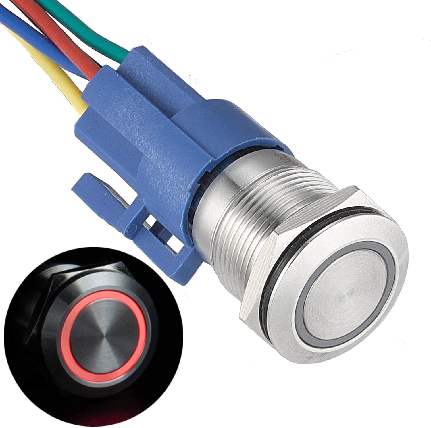

Please provide a link to the source of the switches so I can look at the specs.
Momentary Push button: https://www.amazon.com/gp/product/B075QBJVTS/ref=ppx_yo_dt_b_asin_title_o01_s01?ie=UTF8&psc=1
Regular push button:

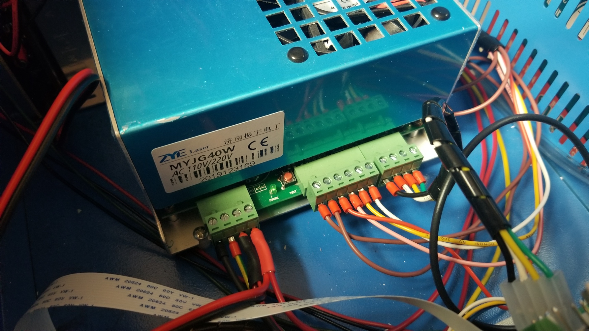

Just for completeness can you post a picture of the connector end of your LPS.
I will take a look at this in the next day or two…

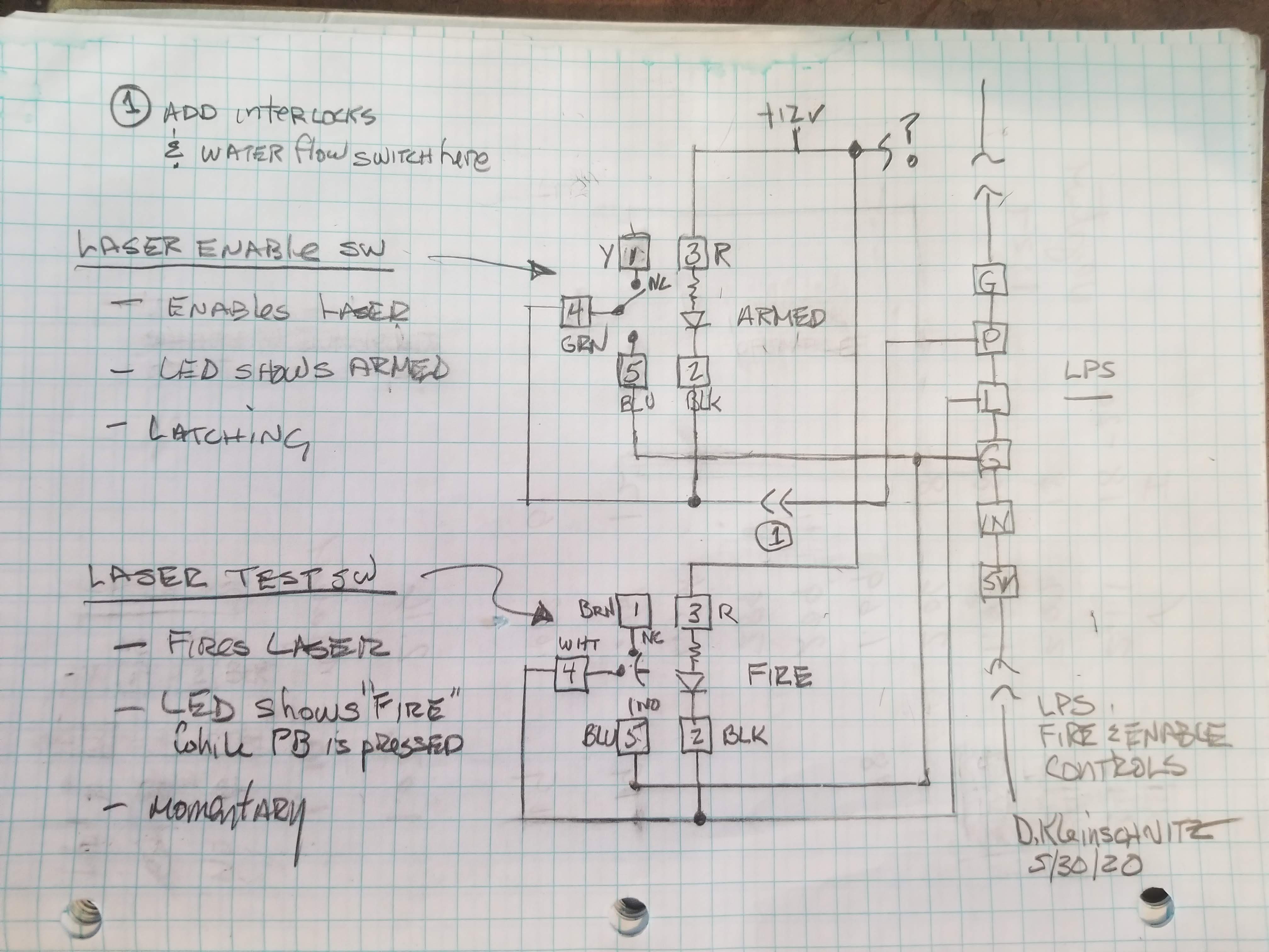

Good morning Sir.
Thanks again for your help.
Attached is a sketch interpreting what you want to accomplish.
Check my work as I did this before coffee! :slight_smile:
NOTES:
Wireing
I used the information on amazon. Warning; interpreting these specs can be error-prone.
LED Power
The leds in these switches are 12v. I assume that means they have internal resistors.
  • Do you have a 12V supply available?
  • If so use it to power the led’s
    ** If not I would consider one because lots of accessories, like cabinet LED strips, use 12V.
  • Otherwise we can try and connect to the LPS 24V.
    ** We would need to measure the switches LED current at 12V to determine what resistance to add in series for a 24V connection.
  • If you use the 5v I suspect the LED will be too dim to be useable.
Armed LED
When the laser enable switch is latched the led in the switch will be on showing it is armed. If the laser enable switch is latched and the LED is not on then this indicates that the interlock circuit is open. I have found this useful to show me that there is a cover open or a coolant fault.
Fire LED
The fire switch will hold its LED on while the button is pushed. This may not be a useful indicator. Since your finger is already on the button the state is obvious? Then again if you push the Fire button and the LED does not light you know something is wrong.
You could wire the fire SW led across 12V and it would be on all the time.
Interlocks
I highly recommend that while you are modifying the wiring add; interlocks on the covers, a water flow sensor in the coolant and a temperature sensor. These can be added in series at point A
Some more information here:
Thank you Sir! This really helped and got me back up and running. I had several of my wires originally going to the wrong places, and your assistance has put me right. I didn’t even think about the 12v power for the LEDs, but I have fixed that as I have a 12v stepper for the LED lights inside the cutting area, and it powers my laser pointer as well.
The only thing that I have an issue with, is the laser is “armed” all the time now and the enable switch actually fires the laser. So when I go to “enable” it, and I press the button, it fires the laser.
The test fire button works perfectly.
I do have a flow meter installed on my coolant tank so I can monitor coolant flow. I also have air assist and an upgraded exhaust fan.
You are a life saver and Thank you from the bottom of my heart for taking your time to assist me.
I’m a bit confused by the above?
  1. When you switch the Laser Enable Switch to ON does it fire the laser momentarily or does it stay on while the Laser Enable Switch is ON?
  2. When you switch the Laser Enable Switch to ON does the led on that switch light and stay on?
  3. When the Laser Enable Switch is ON does the Laser Test Button fire the laser as long as you push the button?
  4. When the laser Enable Switch if OFF does the Laser Test button fire the laser?
  5. Do you own and are able to use a DVM?

It sounds like something is miswired.
Warning: Your machine is unsafe wear eye protection when working on it!
Let’s start by checking the enable function on the LPS.
The laser should only fire when the P pin is at ground potential.
Test #1:
  • Disconnect the wire from the LPS pin “P” and leave it open (nothing connected to it)
  • Push the Laser Test PB
  1. Does the laser fire?
  2. What is the state of the LED lights on the two switches when you perform #6?
Machine history
  1. Is this a new or used machine?
  2. How much usage does the LPS have on it?
  3. Did the enable and laser switch work before you started the modifications?
Interlocks
When we get this modification working properly I will help you with the interlocks … its easy to do :wink:!
  1. after disconnecting the wire from the LPS pin “P” the laser does not fire.
  2. The LED lights light up. If I switch on the “Enable” switch, the light comes on and stays on. When I push the “Test Fire” switch, that light also comes on. So the LEDs are working as they should (I have them connected to a different power supply, one specifically 12v). If I have the “Enable” switch off, and I push the “Test Fire” switch, both LED lights come on.
  3. The whole system is less than a month old. Before I purchased, I did a lot of research on the PROs and CONs, which is why I decided to upgrade the panel and I ordered everything at the same time.
  4. It has less than four hours of total work time.
  5. The enable and laser switches on the original control panel did work before I started the modifications, yes.
