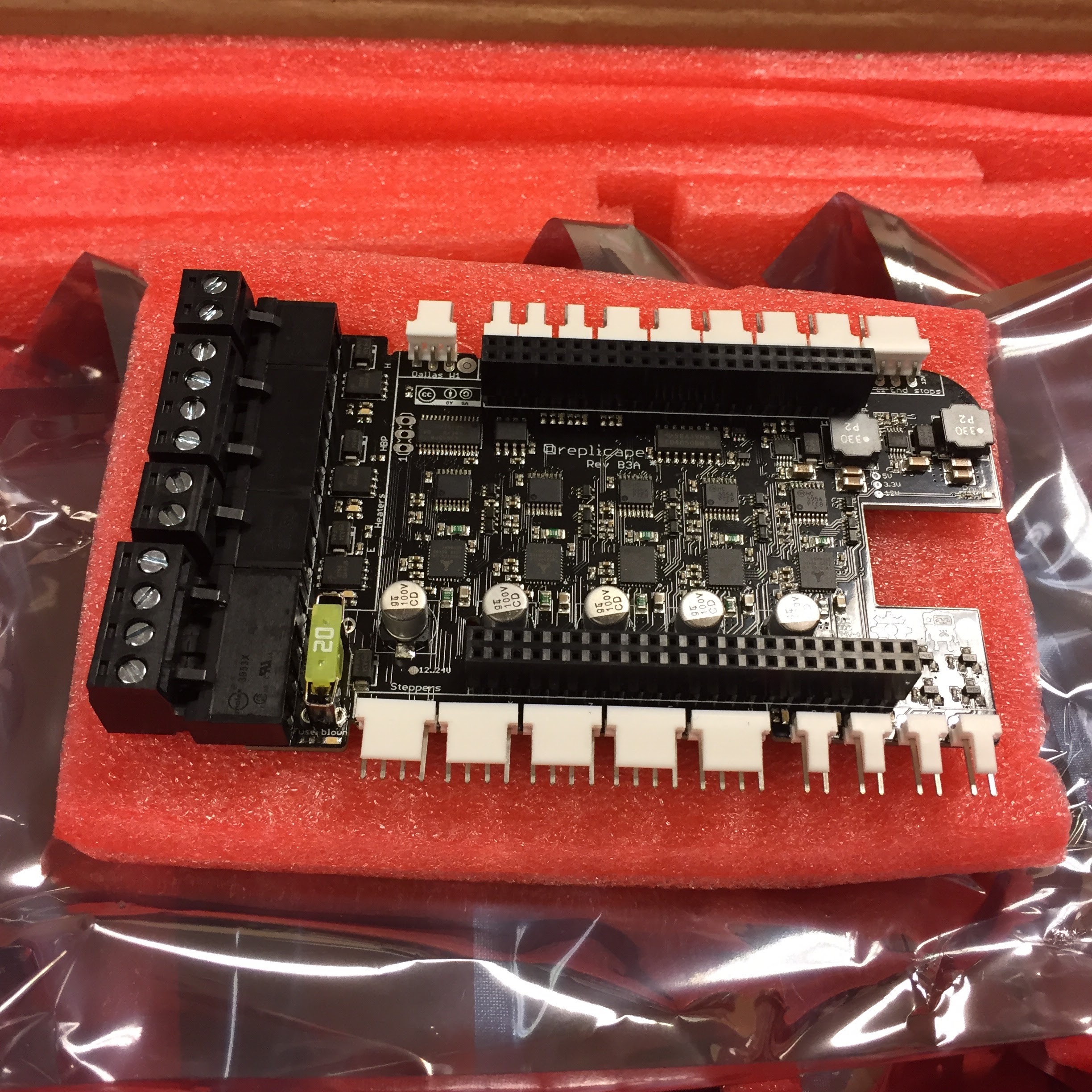

Replicape Rev B3A! Samples arrived today, time to make some test beds:)
Cool! What’s new?
Exactly, what’s new?
No start-up noise, cooler caps, no crooked fan connectors, higher value pull-downs, a boot-hole and a header for the remaining pwm channels. Mostly nice to have features, but worth fixing for the next batch!
Nice. Looks good.

Does this mean all of the current Rev B will be getting a fix for the steppers making noise at start up soon?
Philip, there is not much to be done for B3 to help the start-up noise. Best case is that the second whine disappears, but Imo it’s not a great concern. I’d rather get a new kamikaze out for one, so we don’t have to get ssh access to update the software! My $0.02:)
I’d prefer easier updating as well, but figure I ask.
maybe if its just simple parts upgrade, you could sell a little upgrade kit for the DIY solder people for the main issues solved? Like those caps look like the could be replaced in about 5 minutes with newer ones for example. people always like having the newest and best, i just bought a replicape a few weeks back so a little ouch lol.
anyways, im still building my 3d printer so im not even sure how important these upgrades are so maybe its a non concern for most people
