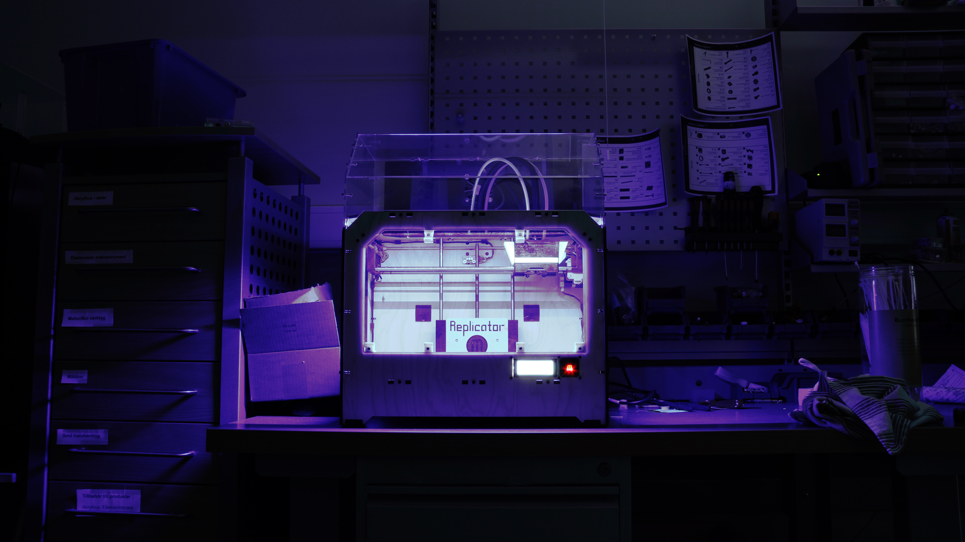

Replicator 1, still working as new after 200 hours of printing…

Our own Replicator2 is almost hitting 100 hours now and still going strong
Sure @Andrew_Plumb , “As new” isn’t really the same as no mods made… Iv’e installed a hot-air-redirect that I created in Rhino. It just simple redirecting unit to draw cool air from above and shoot out hot air upwards in the sides. Nothing fancy, just to avoid turbulence around the printsurface. Other than that it’s stock!
Get at least one of the spring-loaded extruder variants printed (in ABS) and installed ASAP. That will save you grief in the not-too-distant future when the stock delrin plunger-based extruder block fails beyond recovery and/or you want to explore other filament sources where filament diameter varies more significantly.
We’ve logged about 800 hours on our Rep1 Dual and new out of the box it was okay. But as @Andrew_Plumb notes, the extruder upgrades took it to another level. Preheat and level with a dial indicator increased further quality. Then Jetty and Dan released Sailfish, and it became wicked fast and reliable. Enclosed, you get no edge lift off the plate. Hacks and upgrades said and done, it’s nearly always running (we primarily use it for rapid part design tests). We’ve got others that simply have not been as reliable.
