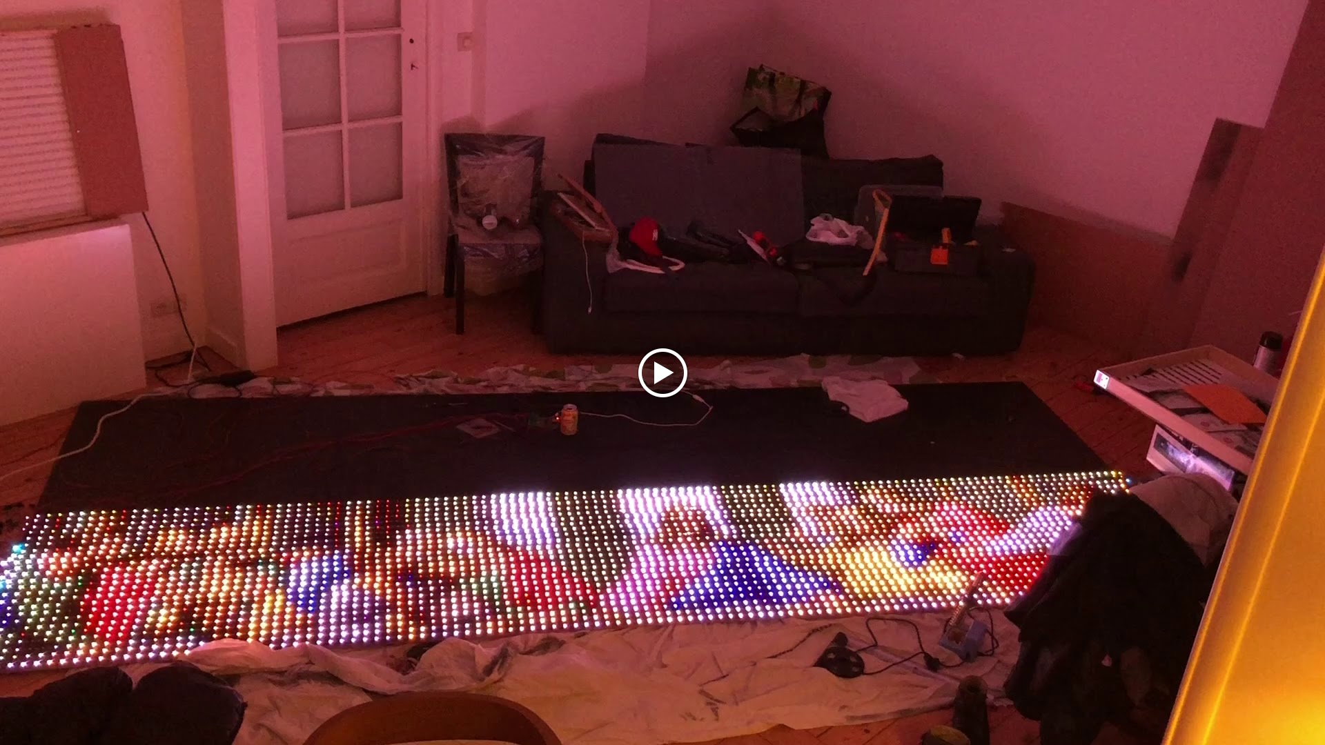

Resolved my issue with websockets (just downloaded the latest version) as I am still
Resolved my issue with websockets (just downloaded the latest version) as I am still waiting for the missing leds here is some coding results.

@Mark_Estes thank you still a lot to do to have it work (the gums and then the move of the ghosts …) but it will be fun
@Sam_Guyer just received the final btachof leds I will try to put as much as I can tonight :slight_smile:

Do you have a shopping list you could share?
@Darren_Hedlund 220m of 30led/m. power supplies 6*40A also I might change them 'cause I am simply getting crazy with those. I am adding lone 25->30 so. I need a new power supply , just hooking up this to the wall plug and everything gets crazy … I don’t know why. Maybe I’ll switch to 3 more powerful power supplies
@Yves_BAZIN amazing Yves. What processor are you using? Did you use capacitors to smooth out the power? I’m not familiar with ‘btachof’ - what chipset do they use?
@Mike_Thornbury yes I have put 16v 1000uF on each strip. I use ws2812 and esp32. Btachof was a typo. ‘Batch of ‘ was what I meant.
