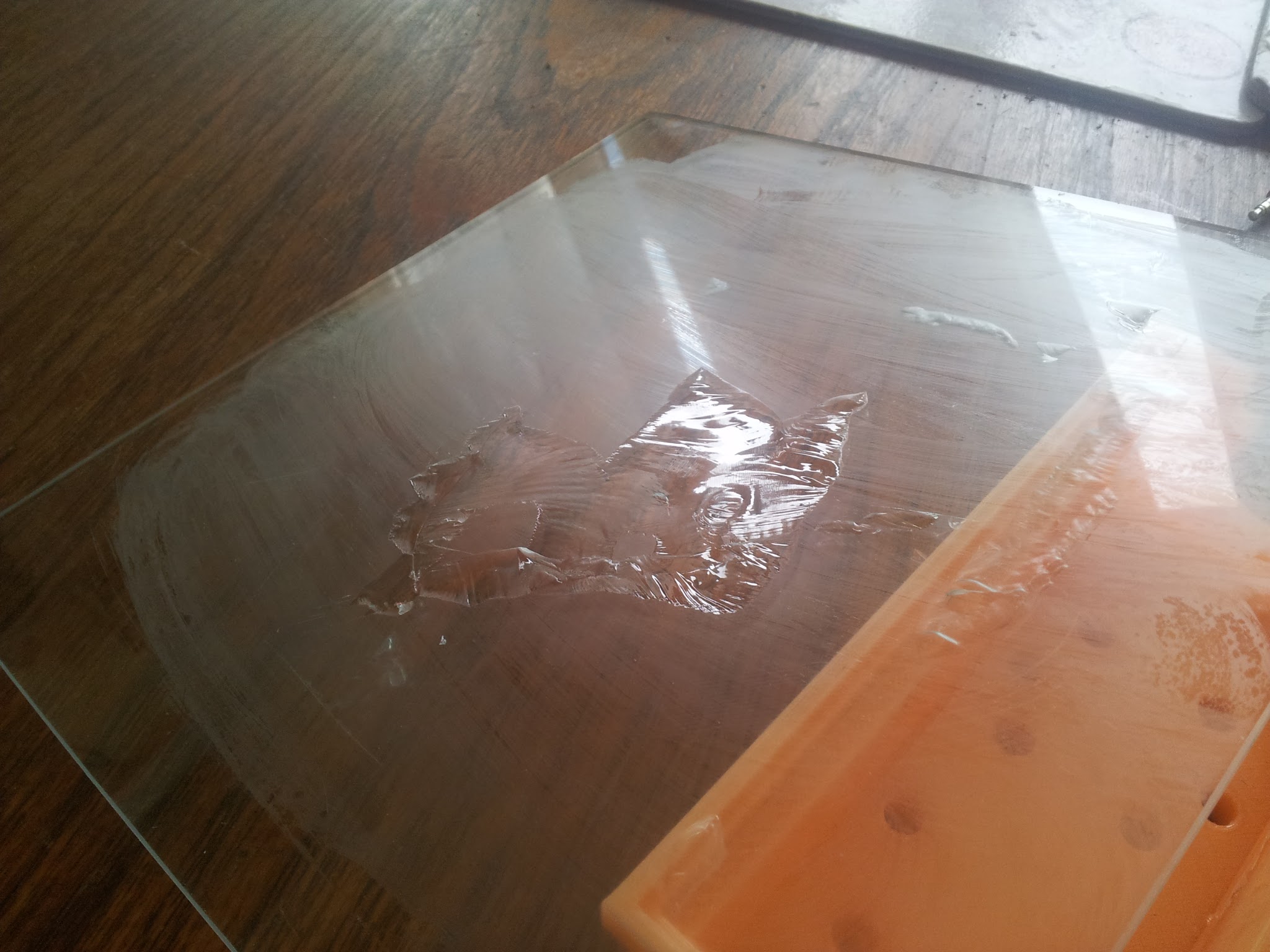

Result of applying a too strong mix of pva glue to the glass bed
woah…i`m printing on water+pva too and the adhesion is really strong but that strong ?
but i mostly use a knife and knock with the sharp side of the blade at the bottom of the printed part until it comes off…did you bend the part off ?
Hi, the part was okay, just left big shells out of the glass. Already diluted down about 20-1, guessing the mix is still to strong lol. But it has solved the warping problem on large parts (150*150 and bigger).
strange…i think my dilution is mostly between 1:5 and 1:10 and it looks much more milky than yours, yours is nearly transparent…i just take some drips water and put 2-3 drips pva in and put it with a brush on the heated bed…but without the knife i think some parts would have broken when trying to get them off…or perhaps the glass

I had the same problem when using nail polish. Switched to kapton tape and the glass doesn’t break anymore.
Good news: cutting glass is super easy.
