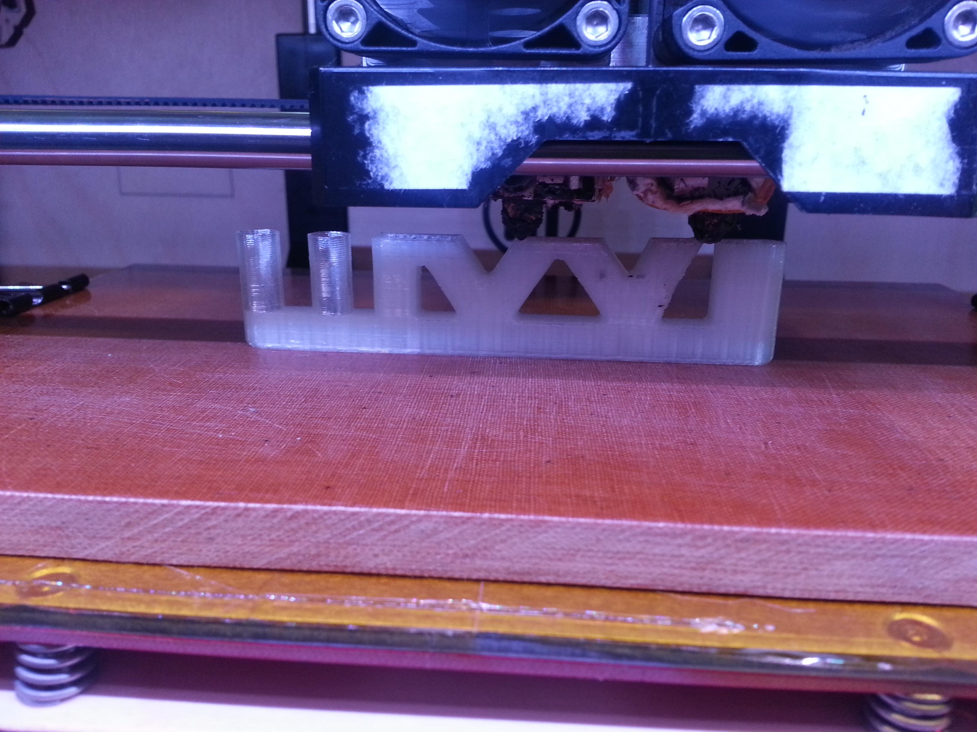

Ricardo Mola Printing Taulman Nylon on a 8mm Garolite build plate...
@Ricardo_Mola Printing Taulman Nylon on a 8mm Garolite build plate…
Thanks , I’m trying but I can’t find here in brazil and some stores in US are having trouble to send it to me
are you heating the bed ?
@Ricardo_Mola no heating of the bed.
many thanks Daniel, I’m going to change something into slic3r and try again
Hello Daniel, I got the garolite to print nylon, my first tentative was not successful, I’m going to try again …
@Ricardo_Mola If you haven’t already scratch the surface a little bit with a piece of fine sandpaper. Just a little and I will stick!
